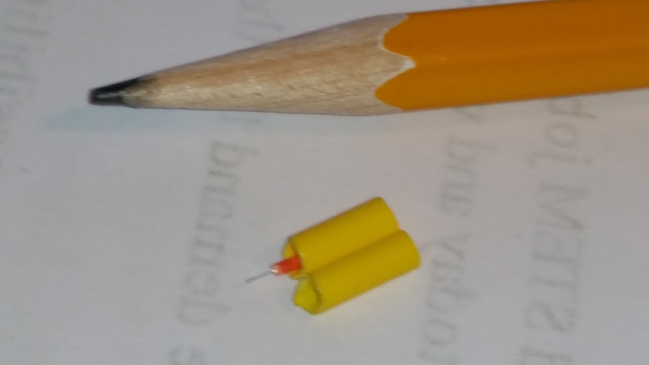

It is tremendously light, I am truly amazed.

- Crudely stripped down a tiny piece of the fiber without the proper tools, actually lost one side. Just a good size comparison
