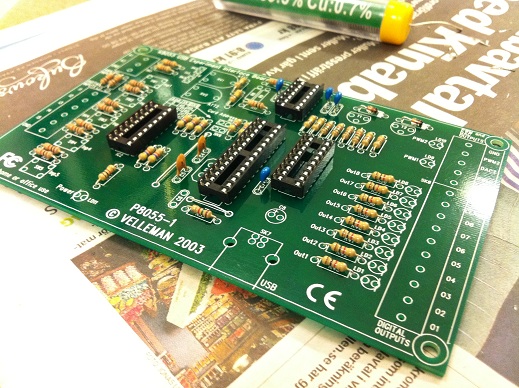

I'm using a Velleman K8055 USB Experiment interface board. I bought it as a kit so I had to solder it myself. The kit comes with some great VB 6.0 code and .NET and there's a ton of code for C++ on the internet. If your new to writing your own code it won't take that much time figuring the demo code out. Especially if you decide to go with VB (Visual Basic) witch is the easiest language out there(?).

Done soldering
Done soldering
Done with the soldering, I got it right the first time and it fired right up once connected to the PC

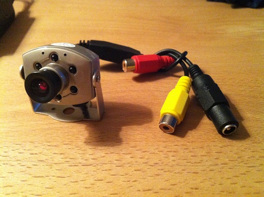

I'll be using a 1/3” CMOS camera (color) with the resolution 628x582.
The camera
The camera

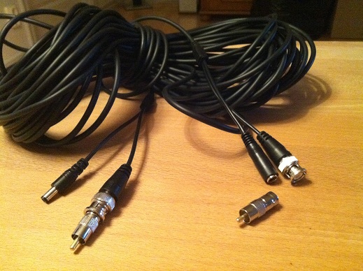

I'll be running a 25m(~80 feet) BNC cable down the tether for live video feed. The cable also covers the cameras powersupply, don't know if it manages to power anything else without getting interference on the camera.
BNC Cable+RCA adapters
Two adapters at each end, both camera and grabber is RCA-female

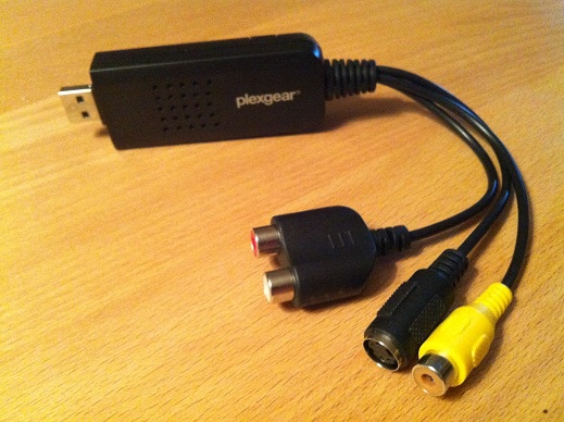

Plexgear Grabber for live feed
Plexgear Grabber, comes with some software I'm might be using

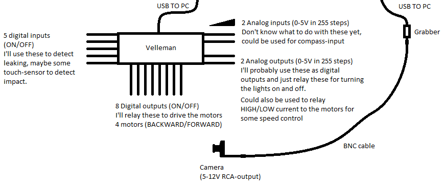

This is how I imagine it to go down, I'm not sure whether I have to relay the signals from the Vellerman before I send them down to the ROV and then relay the signal again down there. Depends on how strong the output from the card is
*Update*
I just ordered a USB extender, it converts the USB to an ordinary cat 5 network cable. Sorry for the bad eng. the plan is now to have the 8055 down in the ROV. This makes my life so much easier since I get one cat5 cable taking care of all my In and Out data.

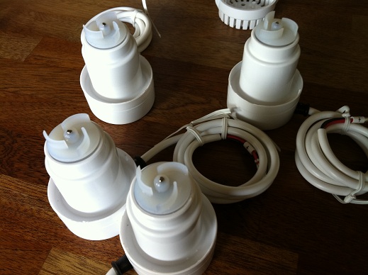

Hi guys. I just bought 4 bilge pump. I also ordered 4 robbe propellers. 2 left and 2 right.
All of the thrusters

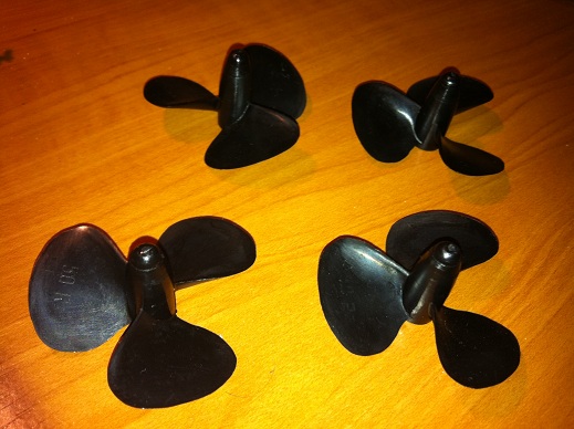

Propellers
Propellers
Robbe 50mm M4 propellers.

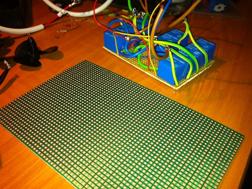

Relays
Relays
I'm building my own H-bridges using cheap 12v low watt relays.
