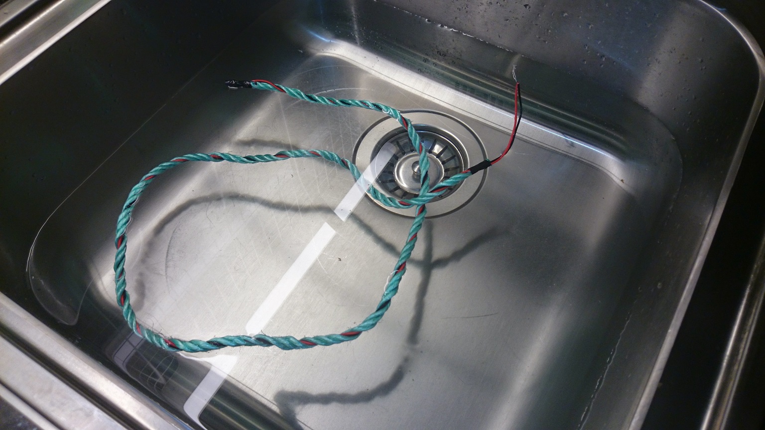

100m (330ft) of 2 lead 24awg wire twisted in to 100m of 6mm floating line. This is normal 3 braided rope and is much easier to come by then the hollow, diamond braided type.
Tested 1m of this in my kitchen sink and it is slightly buoyant actually. Using a thicker wire or thinner rope would maybe be better, but 6mm rope was the smallest they had at the shop I visited. And I guess adding weight to it is easier than adding buoyancy <><
The rope with the wire is very flexible also. Still not optimal as a rope in water will create more drag than a "slick" cable.
I have an idea for a tool that I can print that will help med thread/braid the wire in to the rope. Will give this a try next week maybe.
Any ideas or comments on this thought?

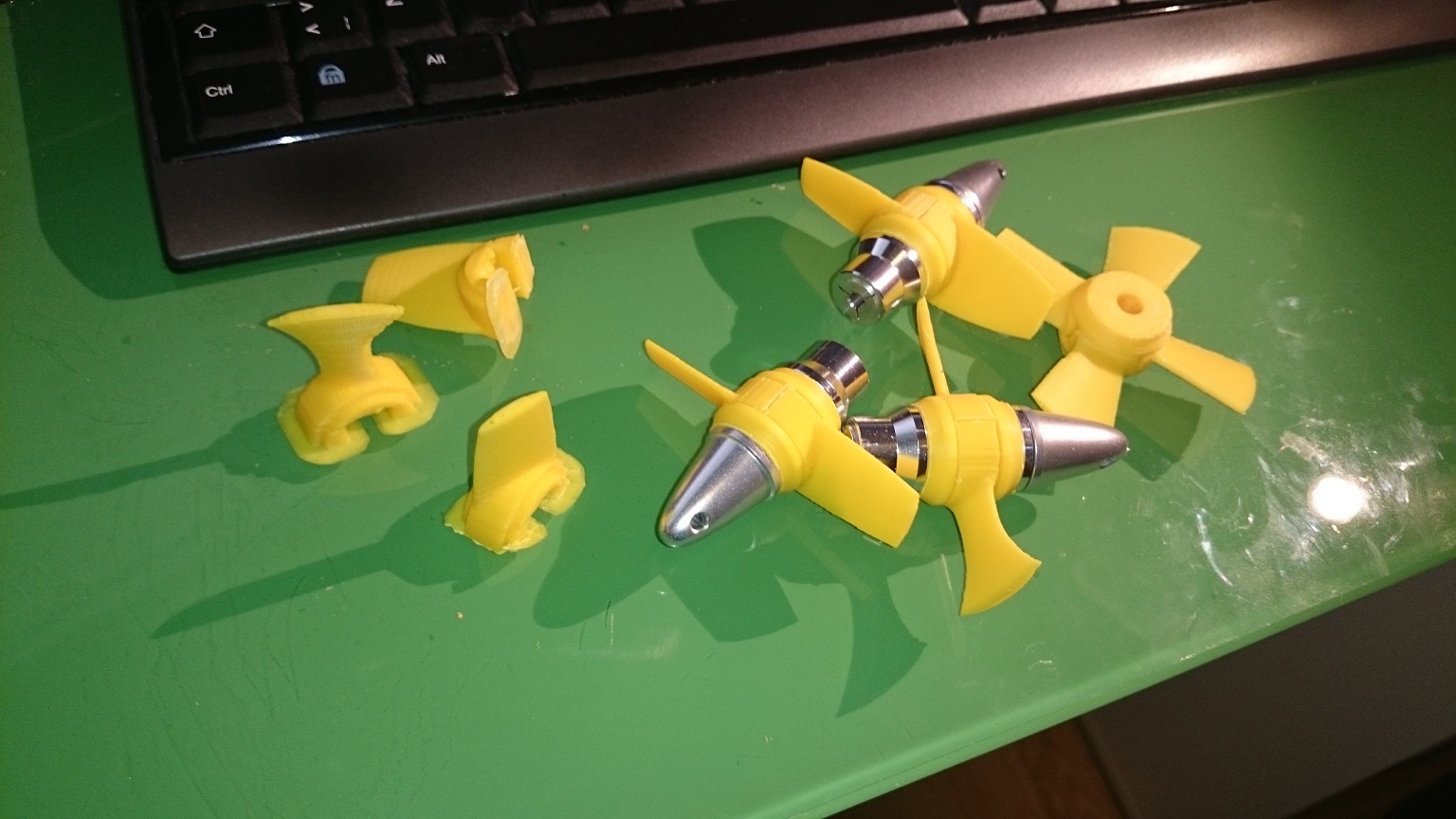

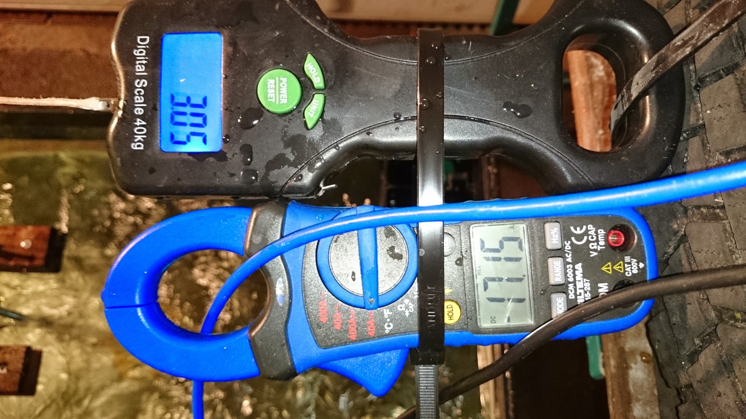

Got to do a lot of testing with different blade types this weekend.
I had a few failures and some interesting numbers. More on that later.

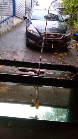

And I'm not done yet. Now that we have a 250l test tank set up I am going back this week to do some more testing with different blade shapes and a few tweaks based on the data we got this weekend.

Wow 3Kg at 17A! That should be enough thrust!

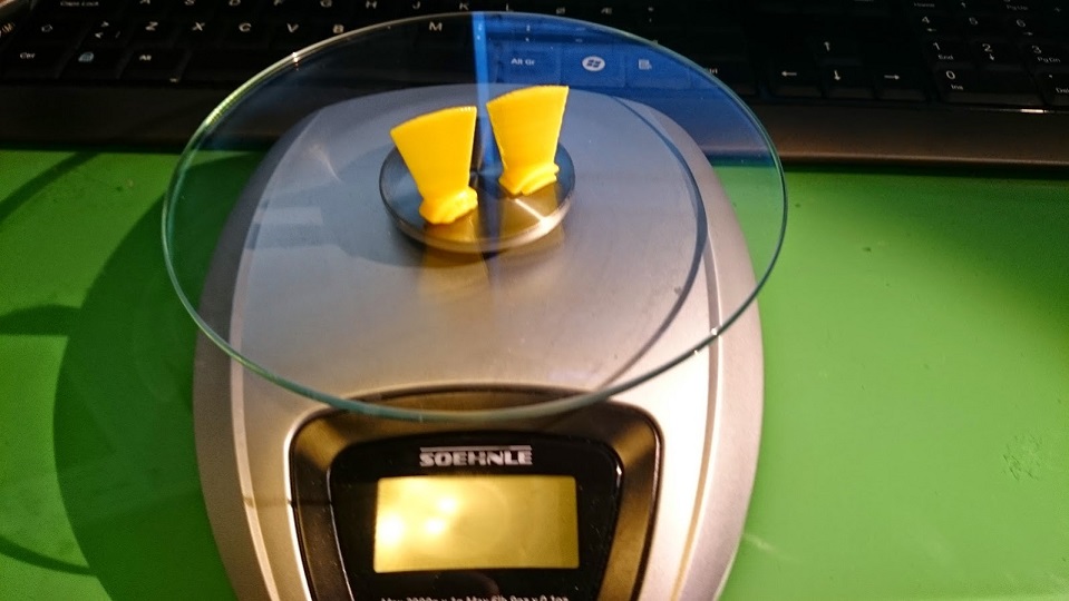

Earlier in this thread I made a post about treating the ABS prints with acetone vapor. I found that test piece today and wanted to see how much stronger that piece was if at all.
While not the most accurate method, I used a kitchen scale and a pair of pliers to press them down to see what force it took before it broke. The untreated piece broke at about 350g (0,77lb). It pretty much broke right showing very little flexing before it broke. The acetone treated piece broke at 1200g (2,6lb) and flexed more towards the end. Thats quite a difference :shock:
Before the test I measured the thickness of these blades to be 1.6mm thick
I should also note that I broke 3 propellers this weekend. All broke when I maxed the speed. So this should eliminate that problem.

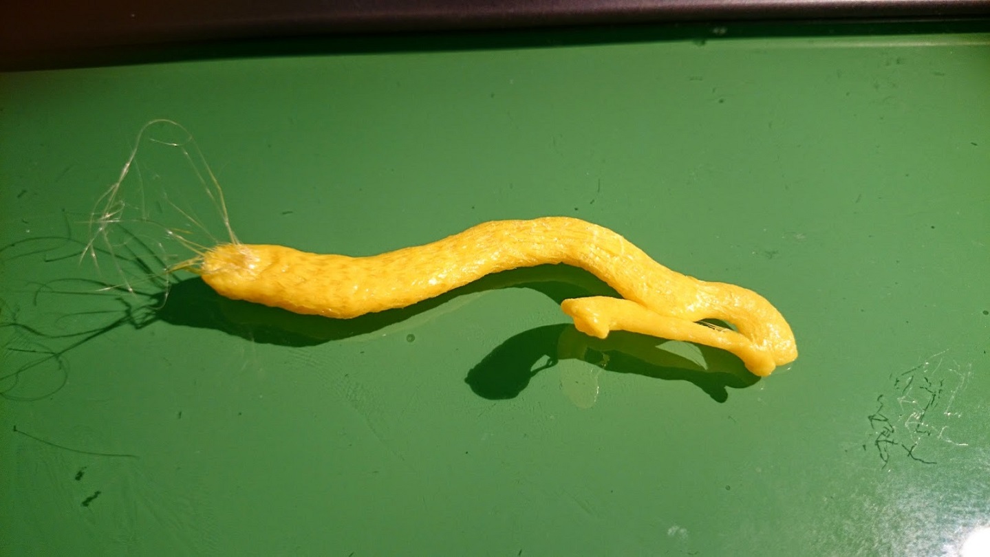

Also, on the second print today I got a phone call just as I started the printer and didn't check to see if everything was ok until 40minutes later.
Seems my printer made some sort of deep sea creature :lol:
