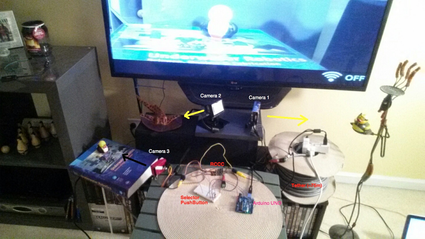

Tonight I tried out (with a HIGH level of success <>< ) my onboard video selector switch. I plan on having 3 cameras onboard my ROV, and this little gadget will do the trick for selecting which one to show on my topside display.
I found this trinket on this site.
The RCCC v2 allows me to select one of 3 video feeds to display, as well as control a flash and the shutter on my GoPro.
The GoPro live feed, power, and shutter control are all controlled via the dock connector on the back. The same site had this cable preassembled and ready to go! I have not tested the shutter, but the power and live feed out work great!
I also tested my video quality when transmitted via my tether. My tether is approximately 75m of 1 core, twisted pair, shielded cable. It "fell of the back of a truck" and my buddy thought I might like it!
Here is the layout that I have. The image is not great...
System Configuration
Here is a quick video.
The three cameras feed into the RCCC. The RCCC then feeds the selected video through the tether to my TV. Baluns are used throughout. I picked up a bag of them from Amazon for peanuts. [url]Here [/url] is the link.
The RCCC determines which feed to transmit based on the signal from the Arduino. The code is so simple!

This little gadget saved a load of time and money and SPACE in the hull of my ROV! A HUGE thanks to the guys at ReadyMadeRC!

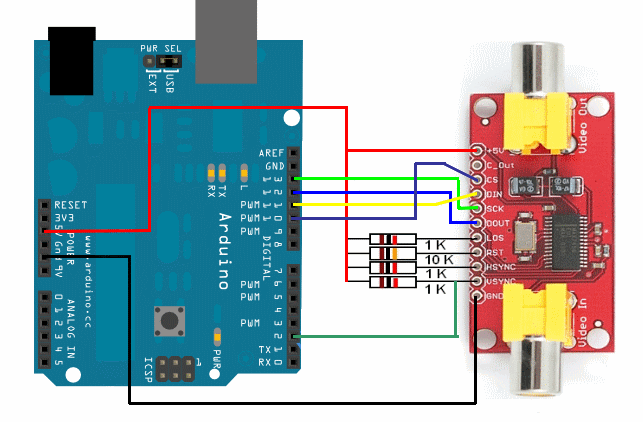

FIRST MAJOR HICCUP:
Well, last night I thought I would hook up my OSD and test it... well.. that turned into a 5hr session of pulling my hair out and overall frustration... I cant for the life of me get the thing to work... I am beginning to think I might have a faulty unit...
Anyone else use the SparkFun OSD breakout board? (I am sure someone on this forum gave me the idea!)
SparkFun OSD Breakout Board
OSD BOB.jpg (107.97 KiB) Viewed 28365 times
https://www.sparkfun.com/products/9168
I have managed to get my video to pass though it... but I cant get ANY characters to display on the screen... I've tried a number of libraries and sample codes... nothing. ANY thoughts? Anyone?

Re: KR2 ROV
Post by kenl »
I did get it working Ryan and as you have there was a lot of hair pulling.
I will see if I can dig up what I did, I can't seem to find it right now.
Try this Sketch to see if you have it wired up correctly

Thanks for the tips! I see you wired the unused pins of the OSD unit to to +5V... Interesting as you are the first to show that... hmmm....
I will try all this on Sunday when I have a chance to get back to it... I will let you know what I come up with!
P.S. Your coding skills look good to me, there are comments!!
"KR2_Diving"
kenl
Posts: 153
Re: KR2 ROV
Post by kenl »
hey Ryan,
I had help from RoarRoar here on the forum, if you check his build thread you will see on pages 3 & 4 our discussion and his results, a truly impressive machine he has built.
Also try a separate/additional power supply for the OSD, it seems to need more than the Arduino can comfortably supply.
Ken
Re: KR2 ROV
kenl wrote:I had help from RoarRoar here on the forum, if you check his build thread you will see on pages 3 & 4 our discussion and his results, a truly impressive machine he has built.
Sadly... nope... not even this worked... I got "Hello World" to show once... no idea how... I was fiddling with something... looked up... it was there... tried again... nothing...
