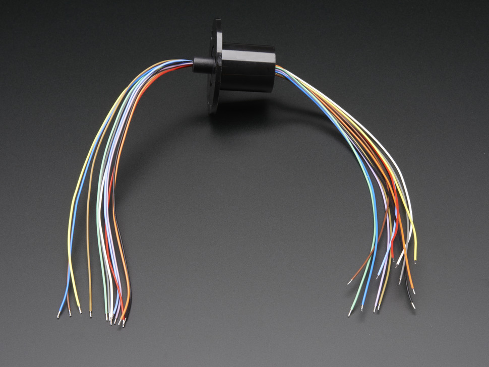

I added another part to my kit today, again from Adafruit. It is a 12 wire slip ring that I will be integrating into my tether / topside control station. This will allow me to better manage my tether. No word yet on quality of the signal through the slip ring, but the reviews seem positive!
Here is the slip ring:
Slip Ring from Adafruit. $25.00!
https://www.adafruit.com/product/1196
My original plan was to fabricate something similar to what Steve has posted on his site here: http://www.homebuiltrovs.com/slipringreel.html.
However, after looking into the materials and labor, (and the fact I dont have a shed full of nifty toys, i mean tools...) I thought for $25 I'd give this thing a shot! I will keep you all posted!

I had the same idea! I'm using the Adafruit slip ring on my setup as well (or at least I plan to when I get the damned thing built!) :)
Good luck and keep us posted on the logger stuff.

Hey guys, Fantastic find on the slip ring! I'll be curious to know how it works out for you. At $25 I'll may soon be buying one soon to test myself!
I had just seen Steve Thone's slip ring design...very ingenious design!
