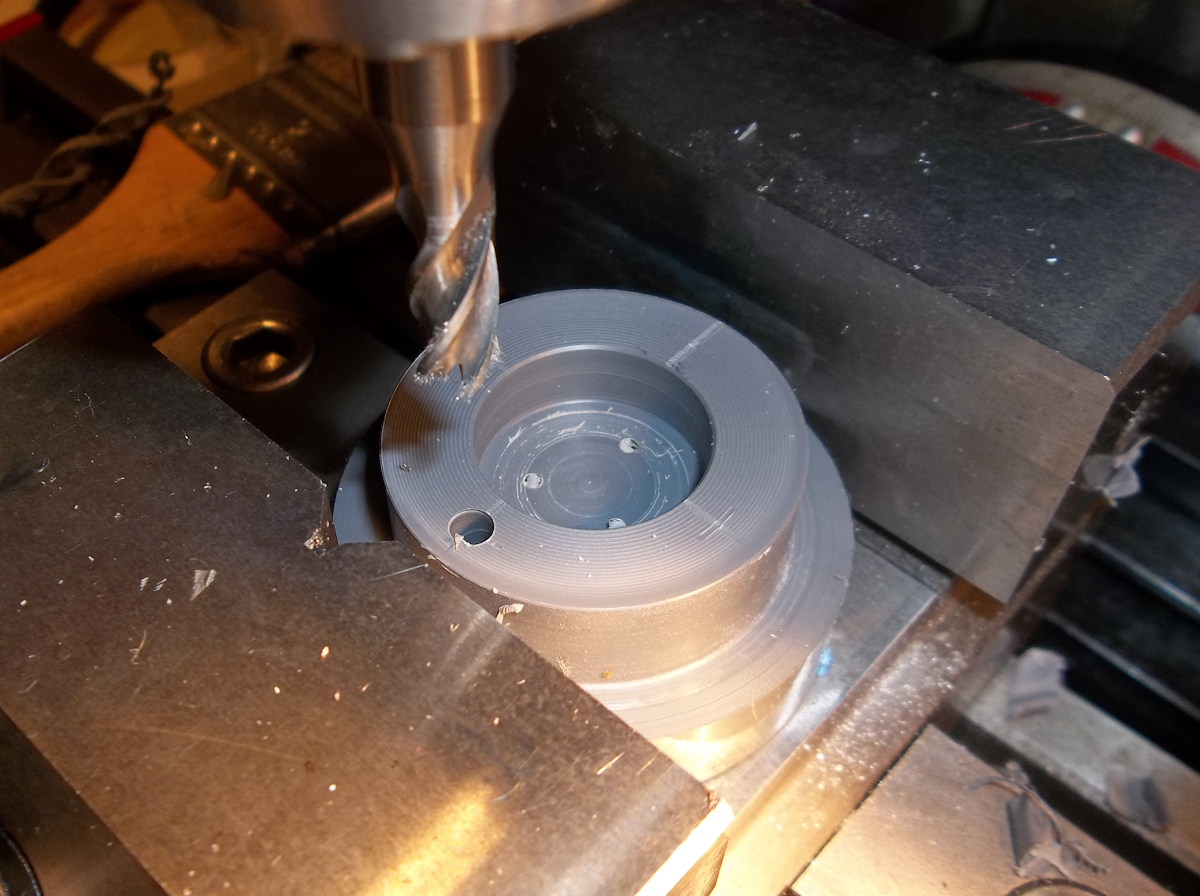

Next it was over to the mill to cut a relief channel for the motor wires.

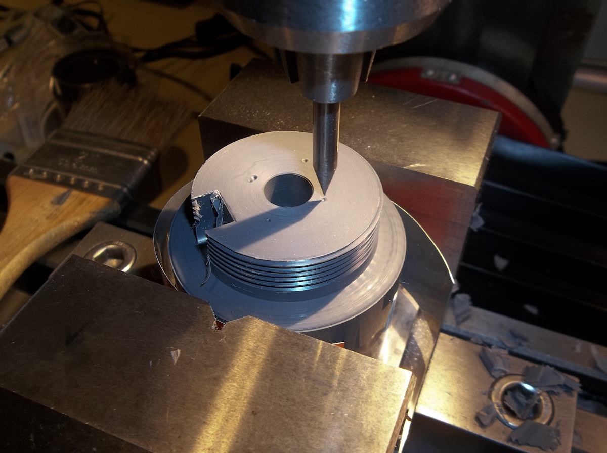

I then mount the piece in the mill and using a center pointer I line up the first hole.
Next I use a center drill to start the hole. This will keep the drill bit from walking and also put a bevel on the hole face for the screw.

I transfer this mark to my end mill and plunge cut the hole.

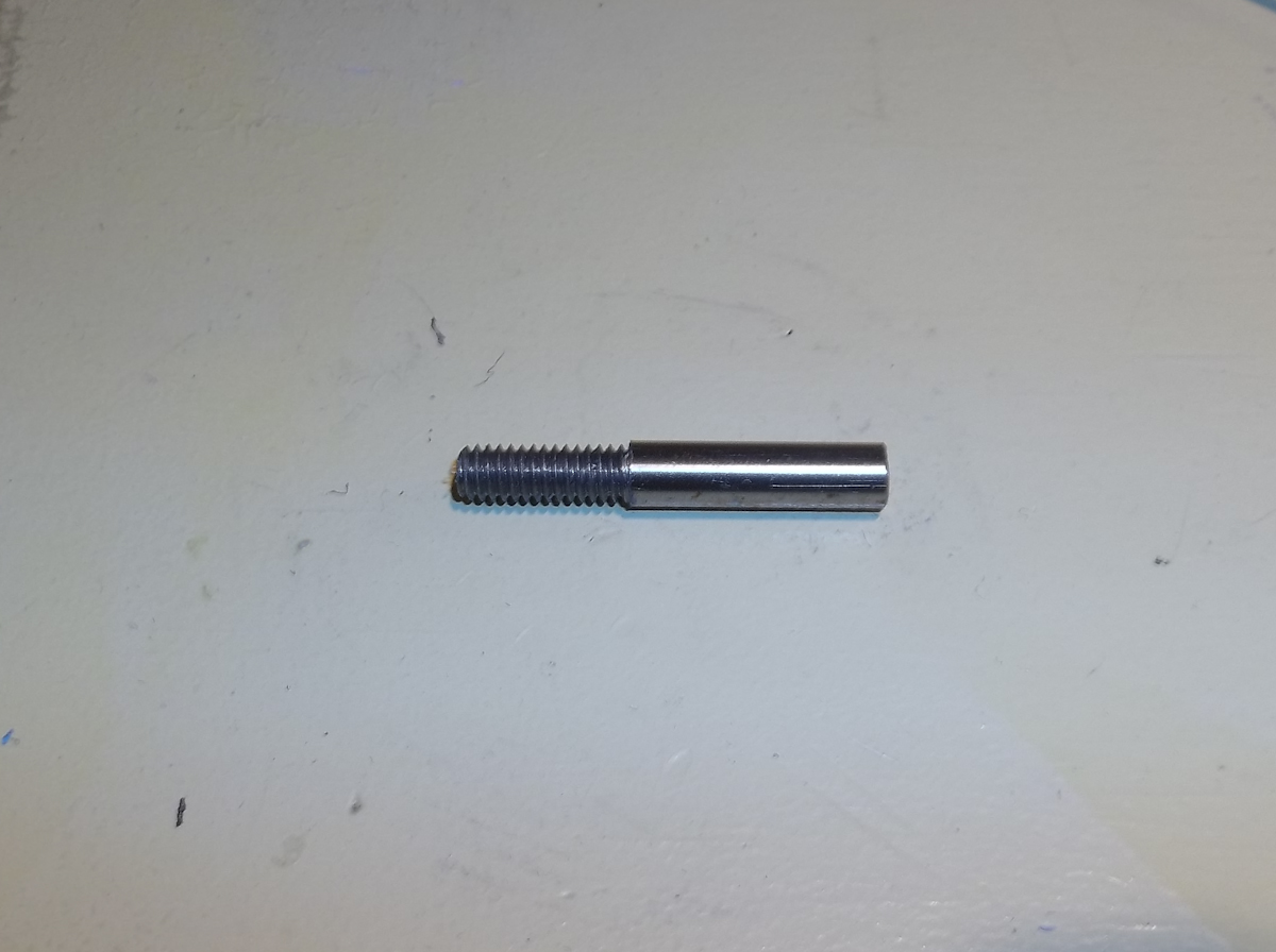

For the shaft I turned down a piece of 3/16" stainless steel rod to .164" to match the 8/32" threads I cut in the cap.
The treads of the shaft are being cut with a die by hand. I use the end of the drill chuck to keep the die holder straight while I start the threads.
To cut the threads I hold the Die holder and just spin the chuck by hand.
Here is the completed shaft.
I quick test fit of the bearings shows me I'm going to need a bigger outside washer on the thrust bearing, the way it is now the rotor would rest against the top bearing and shaft and the thrust bearing wouldn't be doing much. I'll have to turn down a larger washer so the rotor rest against that point and then the thrust bearing will take that load as the magents will pull the rotor toward the housing.
