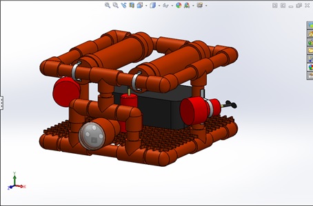

Isometric View
Isometric View

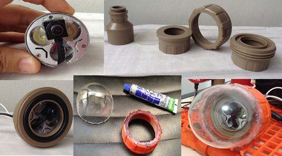

Some material that I am using

Hello tcholas. Those couplings (?) you have used for the lights or camera look like a really good thing. I've looked closely at similar couplings in Australia but unfortunately they were much more bulky.

rossrov wrote:Hello tcholas. Those couplings (?) you have used for the lights or camera look like a really good thing. I've looked closely at similar couplings in Australia but unfortunately they were much more bulky.
Dear rossrov, these couplings are nothing more than a commom PVC Union.

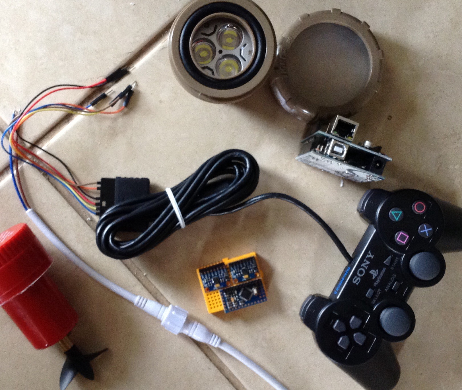

Update 1 : Bilge Pump Control
Here is the bilge pump control system using the ESC BTS7960B and Arduino Uno.
Feel free to ask anything, I'm glad if I can help, as much as I need help in a lot of things.

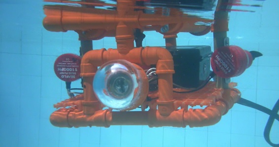

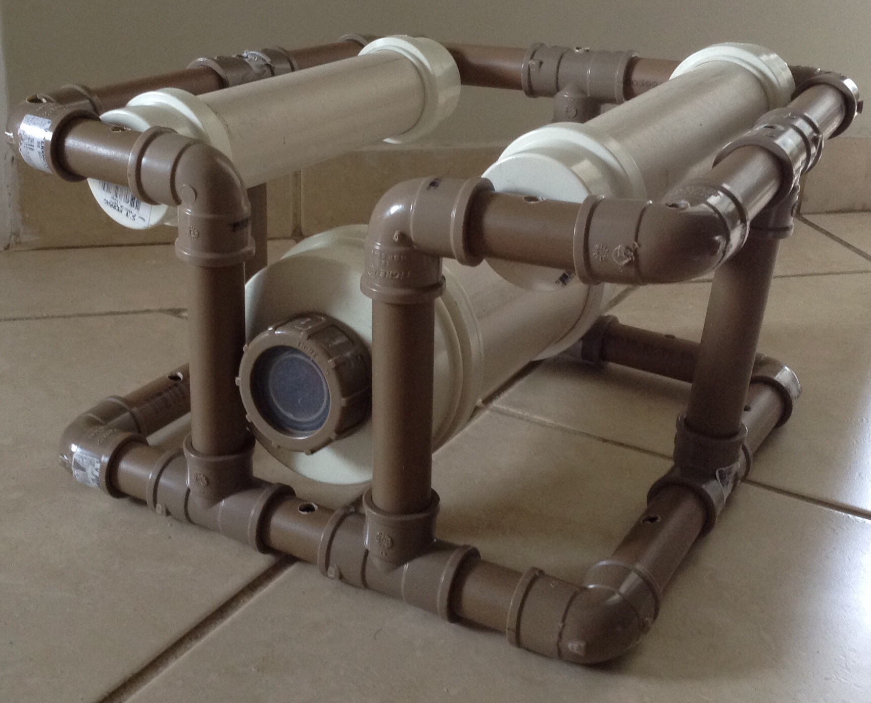

A few months later, many days and nights of work, here it is.
Soon I will be doing the test in the pool, then in the beach. More details in a few days.

Re: ROV from Brazil,
It's looking great, let us know how the testing goes.

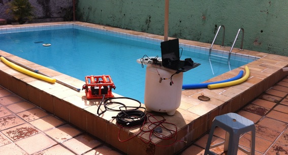

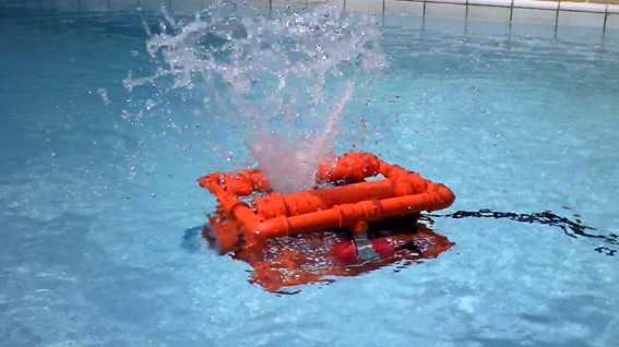

I made 2 tests and It partially succeed!
The control worked ok, but the mains problems was that the left propeller fell off the shaft and the central bilge pump couldn't make the rov sumerge.
After a few modifications, I added weight near the border and silica gel inside the electronic the box, but the umbilical cable broke right in point of connection with the box, and I couldn't do more tests.
I made a video, soon I will post.
As I have time to conclude this work for the university, I can't spend more time modifying anything, I have to present the way it is.
