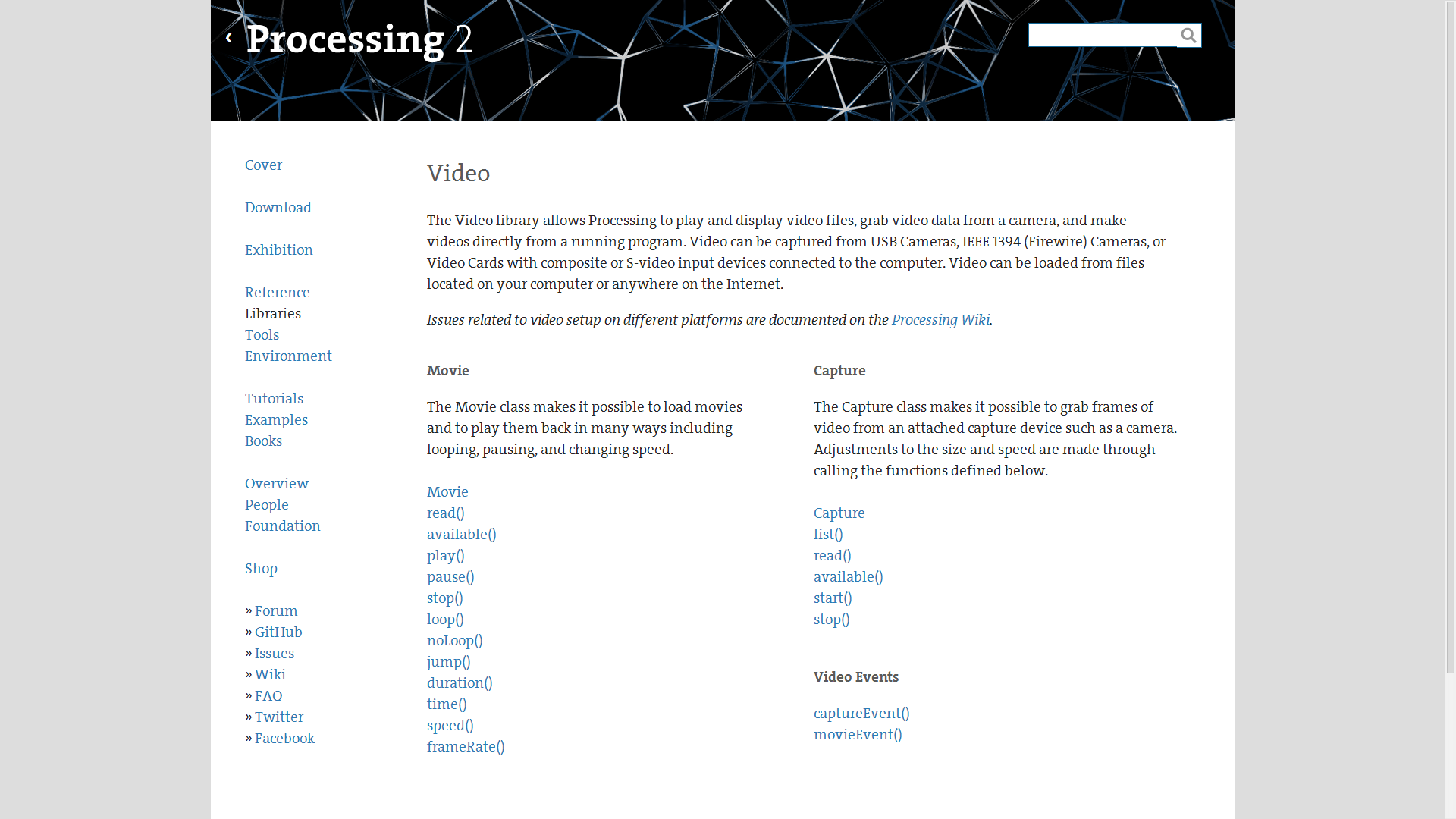

And below is the basic API for the video libray. Nowhere is it very specific about how to use all of these though. The difference between a USB camera and the IP camera is it looks like a USB is a Capture object, that reads frames that are coming in through a buffer, and a webpage is a Movie object. However I don't know if it will allow a Movie object to be created from a webpage video that still isn't complete, i.e. a live feed.
