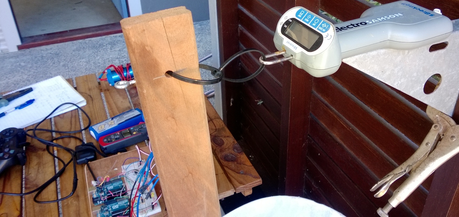

I've finally done some proper tests on my thrusters.
Components:
Motors = Turnigy D2836/11 750KV Brushless Outrunner
ESCs = HobbyKing Brushless Car ESC 30A w/ Reverse
Props = 52mm Ebay props and a 75mm CPU cooling fan
Test rig is in the photos
Sorry about the Kgs (1 Kg = 35oz)

I think the 52mm prop outperformed the cooling fan especially in the top range, and it required no extra effort to fit, whereas the cooling fan had to be stripped from it's motor and the adapted to fit.
Next week I will modify a prop shaft so that I can fit 2 x 52mm props back to back, one facing forwards and one back. The aim is to even up the FWD and REV thrusts?

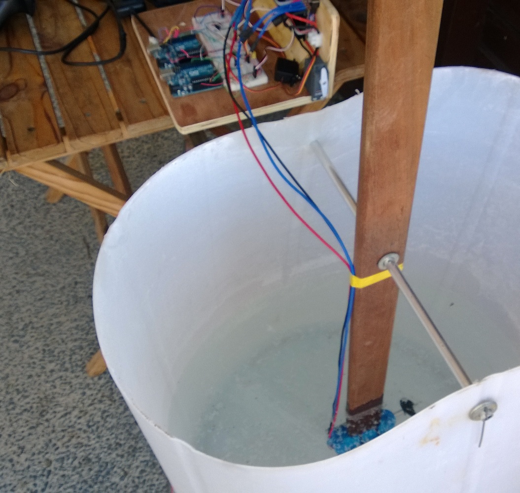

Test Rig
Test Rig

Good post Ken. Are we having too much fun yet? :D I'm wondering how the thruster body is affecting flow and ultimately thrust when in the flow (downstream) from the prop? In one of the photos it looks like the concave face of the prop is facing away from the body. Maybe stick it on the shaft the other way round and re-test forward vs reverse, if you haven't tried this already. My thrusters have the props on this way but I haven't done any measurements to confirm.

I've thought about that a lot too Ross, the prop is smaller than the housing? I'm not sure if I have the prop on the right way around and will try the other way, work is getting in the way this week!!
There are many options I want to explore, one being the props in series (back to back), then I want to see the difference a nozzle makes and lastly a prop at both ends of the thruster housing, but that is mainly as a bow thruster set up.

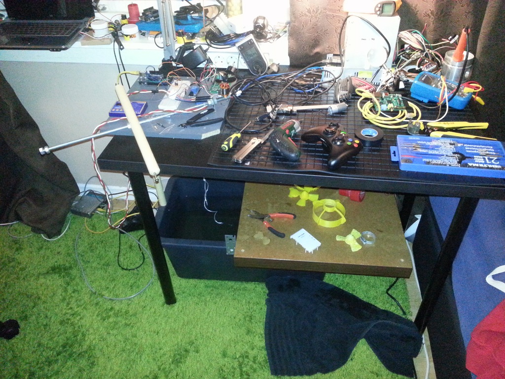

I managed to get some testing done today.
Motor: Turnigy D2836/11 750KV Brushless Outrunner
ESC: HobbyKing 30A Boat ESC 3A UBEC (water cooled, ordered the wrong one)
Prop: Graupner 2308/65L
Tank size unknown, see pictures.
I basically only measured the max force i could achieve with this motor/prop combo and only tested in forwards direction.
It maxed out at 2.3kgs while drawing ~190W and @12v that ads out almost 16A right? This is measured from the mains power socket, since I only have the equipment to measure at the mains socket, so this is including what is lost in the PSU.
And yes, I live in a small apartment that I share with one other person, so all my ROV building and testing is going on in my bedroom :?
