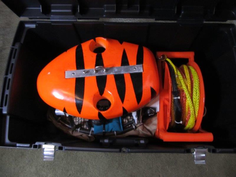

The main storage box with TMS and ROV.
Storage Case

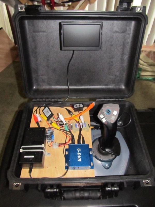

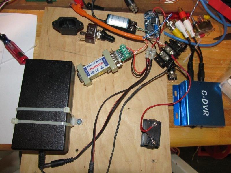

The topside control box in a 1450 Pelican Case. The monitor will be upgraded eventually.
Control System

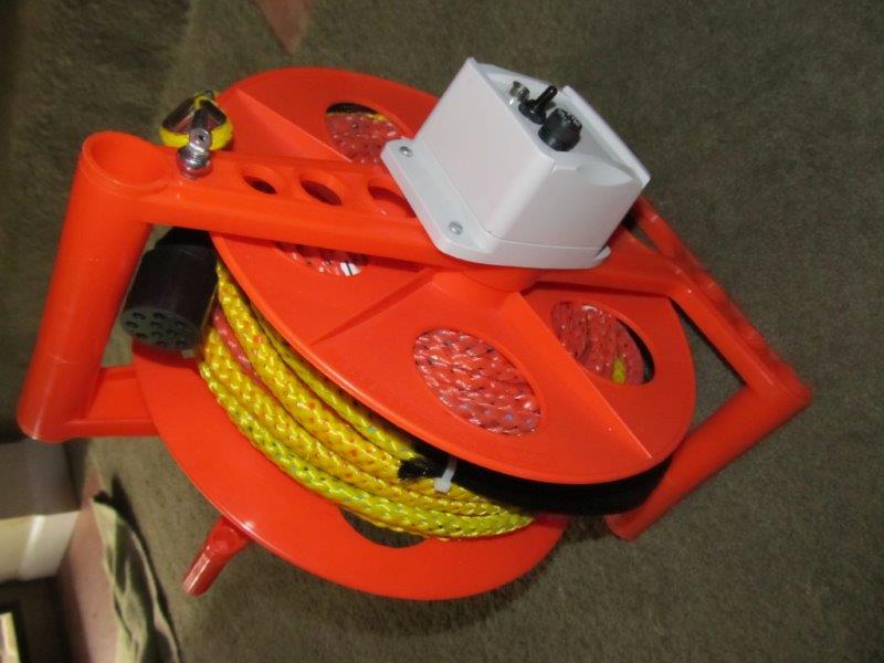

Tether Reel
Tether Reel

I noticed you shared a few more detailed pics of your whole system. I'm curious about your tether. I don't see any obvious floats. Is yours neutrally buoyant? If so, care to share some of you design details?
I'm also very interested in what kind of slip-ring you made/acquired for your TMS system.

TigerShark...I took a look at the document for your design and found the answer to my tether question.
Would still like to know about the slip ring though...thx.
