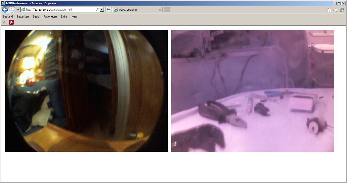

Best result I got so far, is using mjpg_streamer with 2 webcams (Logitech C510) (ofcourse no OSD (yet))
Code: Select all
cd /root/mjpg-streamer
./mjpg_streamer -i "./input_uvc.so -n -f 25 -r 640x480 -d /dev/video0" -o "./output_http.so -n -w ./www/stream2 -p 8080" >/dev/null 2>&1 &
sleep 2
./mjpg_streamer -i "./input_uvc.so -n -f 25 -r 640x480 -d /dev/video1" -o "./output_http.so -n -w ./www/stream2 -p 8081" >/dev/null 2>&1 &
Viewing using IE
http://<PI IP Address>:8080/javascript_simple.html
http://<PI IP Address>:8081/javascript_simple.html
Or make you own webpage, using <IFrame>, you would get something like this:
Schermafdruk 2014-10-29 13.04.17.png (662.1 KiB) Viewed 54236 times

Indeed, resolution is 640x480... It could do better, have tested 960x720.. But that didn't fit on my screen side-by-side anymore :)
Its using about 10% CPU for each stream (100Mb connection), I am sure it could do 4 streams (not tested)
Not sure how many FPS I get, I have set F 25... no errors show ;)
So looks real-time (eq motion, looks like motion.. no stutter), which is good enough for me.
