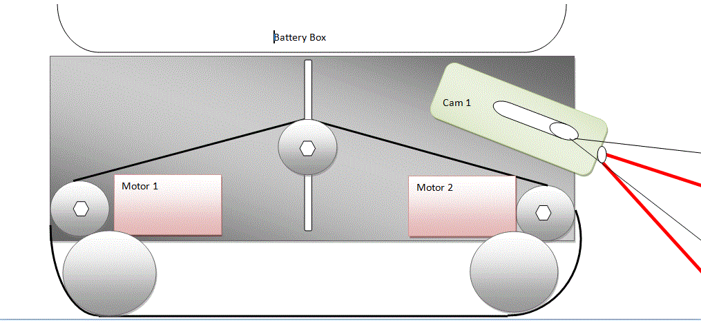

Right now I am in the process of getting two window control motors from a car to operate the turning of the cogwheels on the tracks. Once I get these, I can start figuring the size of the main box that will be mounted to the crawler. I am planning on using a detachable box that Wal Mart sells which is made of plastic. It will mount above the main box.
The two cog wheels on the bottom will be spread further out to the front and back for stability purposes instead of directly under the vehicle.
The light is mounted on the outside of the cam tube.
There are 4 motors not just two, the other two can't be seen because they are on the other side but they are connected to the same power supply.

Your Rov looks ok and your basic idea is ok to.
So can I ask... How deep do you think you can go with this (feet, metres...miles..!) Just asking because the depth can alter my advice.
In theory a tracked rov can go all the way to the bottom of the ocean. I have had them down around 1100 metres.(3600 feet)
Regards
