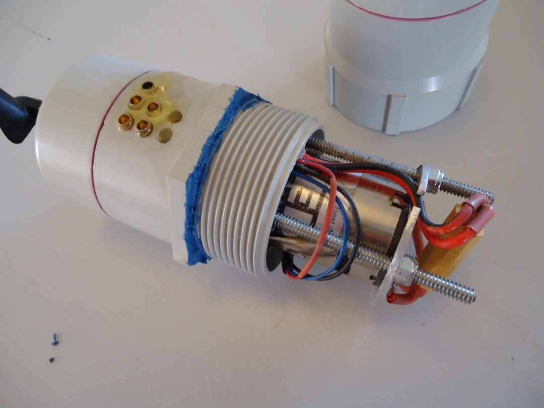

So I've pulled in the test bed, and look forward to uploading the Arduino code and testing the latest revision, after remapping ESC values and control values. I've also got the code written for 3 temperature sensors, and one has already been mounted in the right motor housing. I'll upload a photo when i get the chance. My next step is to run some tests with the completed motor housing and ensure everything is working as it is supposed to before completing the second motor housing which is 3/4 done. I'm also looking at using lipo's instead of lead acid battery's due to the weight and space it would save. It also seems easier to run some 2s and 3s as required, rather than a couple of 12v batteries with a few regulators stepping down voltage as required. I should really spend a few minutes drawing up a circuit diagram.....

Its great to have pulled the ROV out again after another break. Since my last update, I have completed the internal motor chassis that fits inside the semi-complete pvc watertight compartment. I say, 'semi-complete' because it is not yet watertight. I've got a flange bearing on the end which i suspect will leak water but I wanted to complete the rest of the housing before water testing. I have an alternative to the flange bearing if it fails, using magnets in a clutch like fashion. I'm sure its been done before but i did a quick sketch that looks sound if i need to use it.

Looking good. What are the bolts around your arcrylic faceplates bolted to? Have you glued a flange onto the pipe? Mine also has a gasket made from a car inner tube. Fantastic stuff, inner tube.

KDM wrote:Have you glued a flange onto the pipe?
Absolutely right, KDM. I found a flange that fit nicely inside the main compartment. I think I got the inner tube idea from this forum! but might make up a aluminium plate to act as a giant washer behind the flange, as its a little on the thin side. I'll obviously know for sure when I do some water testing!
