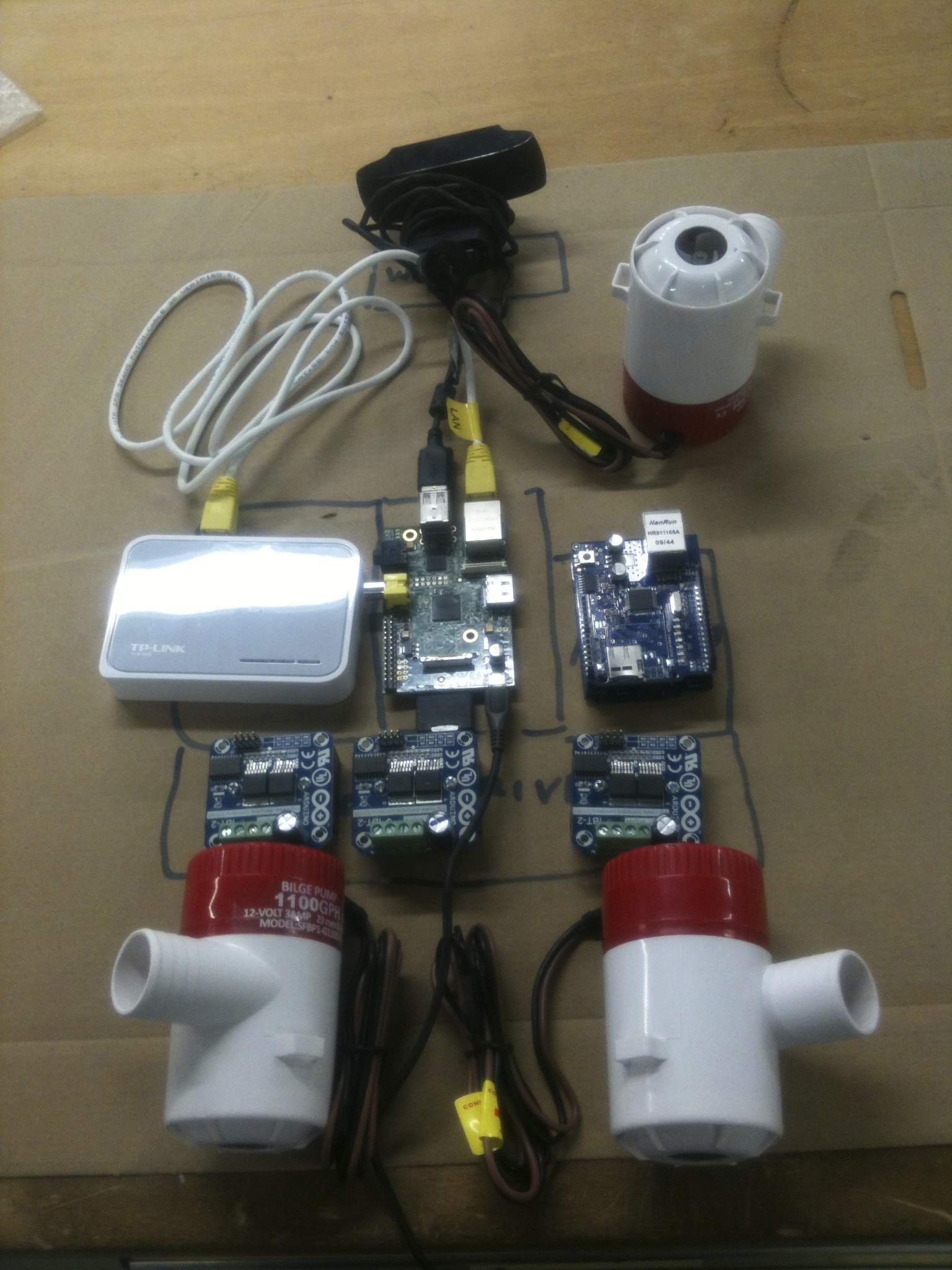

I’m a newbie I have being doing a lot of reading of the forums and research and now I think it is time to start my own ROV,
Here’s my progress
(living in a small space so have to pack them away everytime I finish doing a bit of work)
Here’s my progress
- Parts ready to be attached

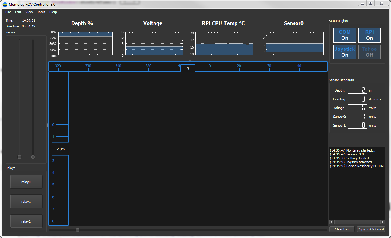

Firstly big respect to Chris Konstad I am using Monterey his laptop based topside application and I really must say it is an amazing resource to make public so much appreciation to him.

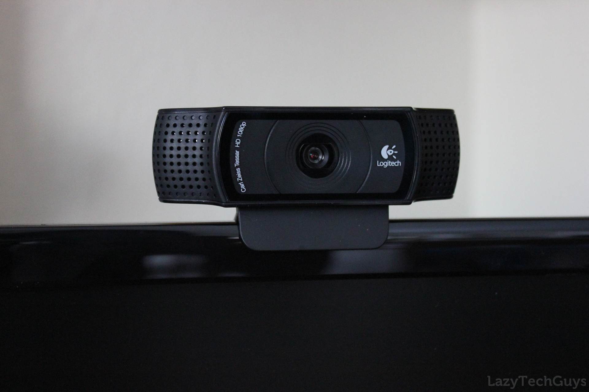

The Application is amazing the Video feed is taken via a raspberry pi through ethernet to the central field area the camera I’m using is the Logitech C290 it is working well with the raspberry pi and monterey if any one is looking for a camera for this setup.

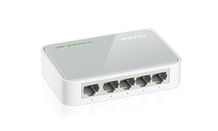

The Ethernet is managed by an old broadband router that I had lying around the house on the topside and a small 5 port switch in the ROV its a TP-link something or other, it was the cheapest and smallest I could find that will run on a 12V battery

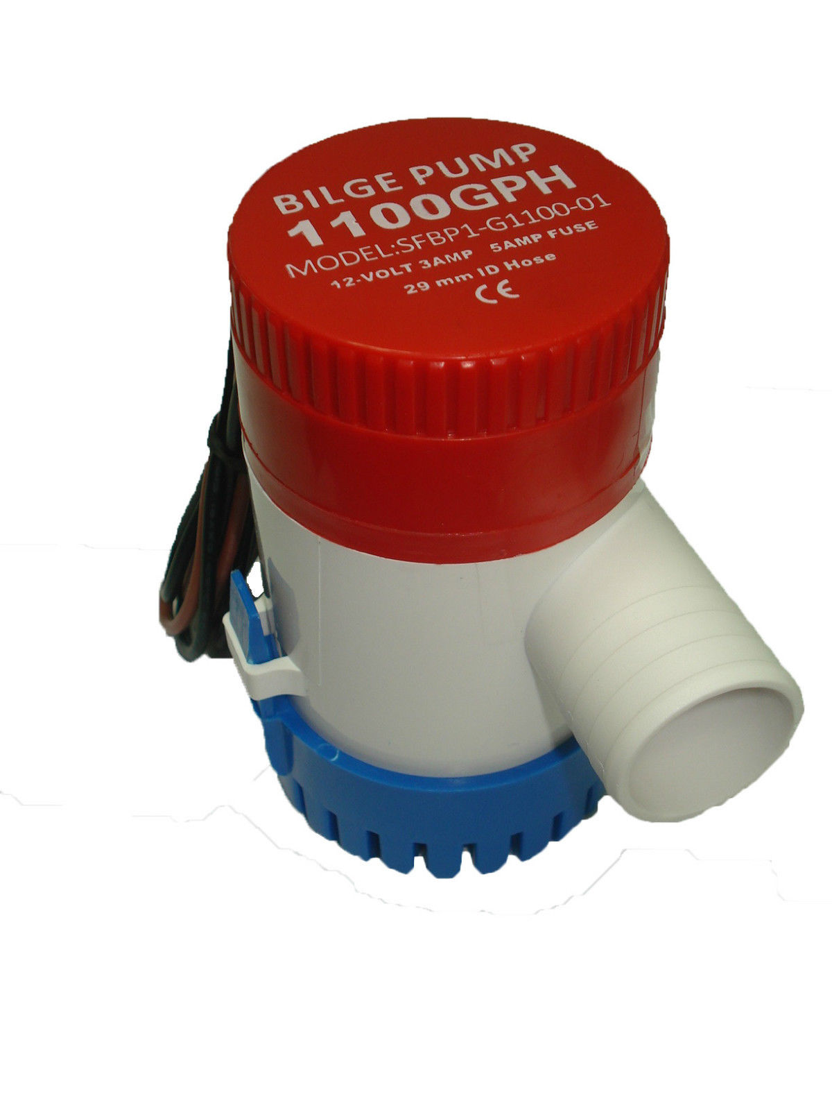

The Motors are 3 Bilge Pumps,
like I say I am a newbie and thought this was a good idea but the more I read the more I begin to question myself anyway they are 1100 gph bilge pumps from ebay
So with a couple of lines of code I can control the motors direct from the arduino with PWM but my current problem is changing the bottomside code for the arduino to control these motors.
