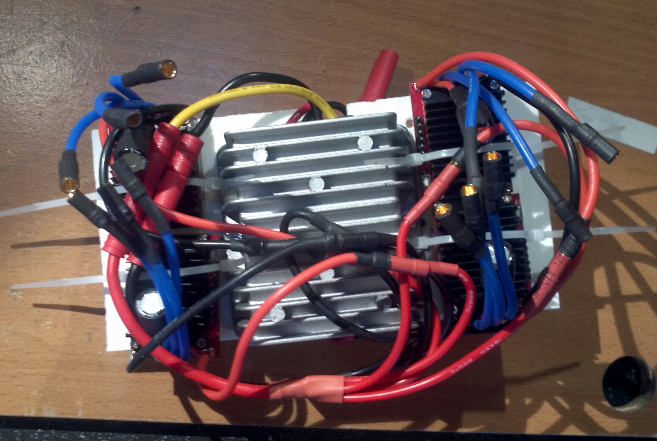

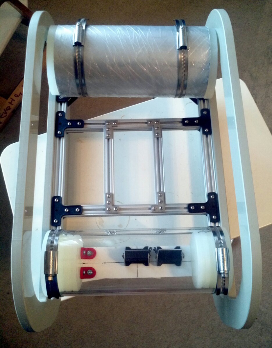

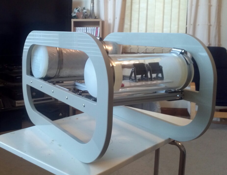

Thought I would update you on where I am with the build have most bits just a lot of work to get it together!
Jonny
Lots of wiring to tidy up on this side!

very nice :D
Are you going to run on-board power, or through the tether ?

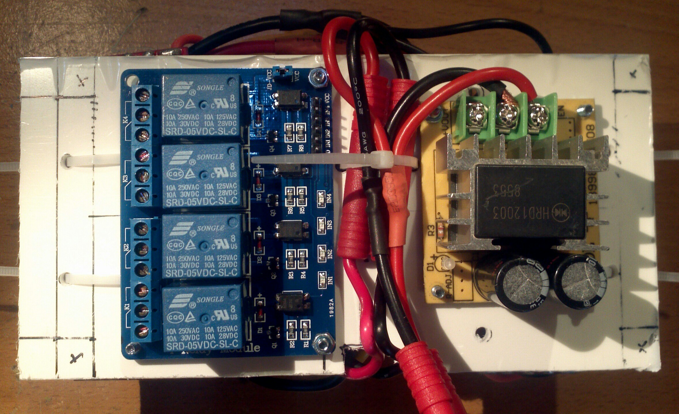

Hello,
I am going to run power through the tether the large silver housing is a 48v to 12v 20amp voltage regulator and 4 no ESC on the revese side is a 48v - 12v 3amp regulator for the control & LED lighting there is a bank of 4 relays for lights etc, just waiting for a control board to try an fit on or will place in the forward compartment.
cheers Jonny

Really clean build mate! Great job!

Hey, I was wondering something. It looks like you have two cameras in the front tube why do you have two?
