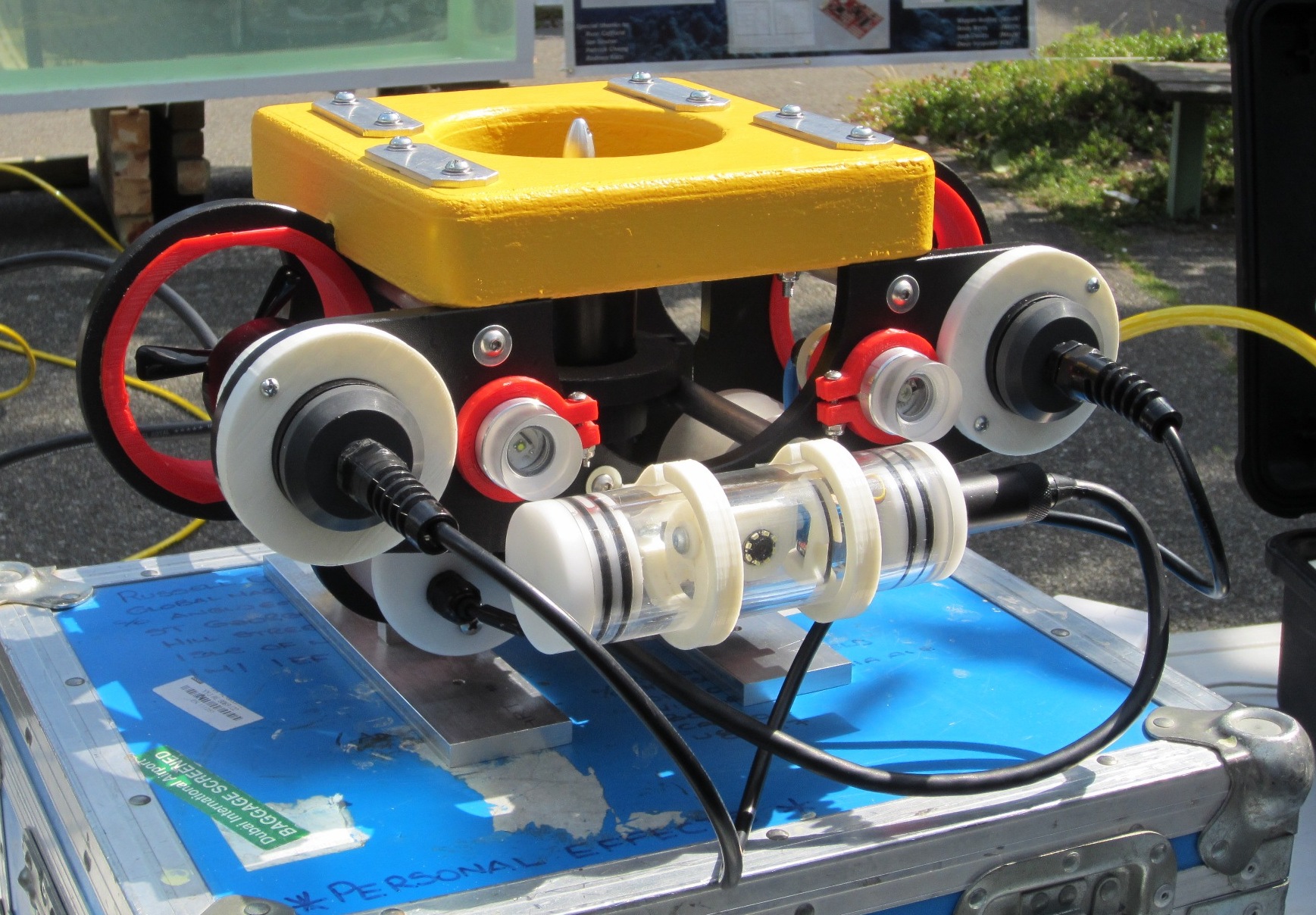

Anyways, I bought some plans for an ROV from ebay, it was a University project and looked like this

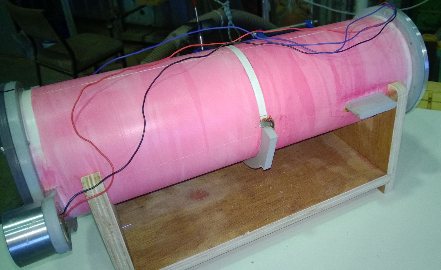

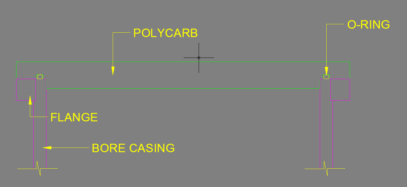

My basic hull is a 460mm (17ish ") long piece of water bore casing with an ID of 127mm (5"). The length is 460 due to the limitations of my lathe and I wanted room for expansion (380 would have done) The diameter is 5" because 100mm (4") was not big enough to fit all my electronics and batteries (6x 5000ma 3s packs) confortably, and bore casing because it was the only pipe type that I could find in that diameter, with the added bonus that bore casing is designed to withstand the pressure applied from the outside... apparently :?
I trimmed the pipe to size and skimmed it's entire length, I wouldn't bother with skimming it next time.
I then rebated the ends so as to reduce the OD by 1mm to provide a shoulder for the flange to sit against.
Using a CNC router I machined some flanges out of 10mm PVC flat sheet and glued them to each end using standard pipe glue and primer, primer everywhere!
The ends of the pipe and flanges where then machined flat on the lathe.
The front cap was cut from a sheet of 12.7mm (0.5") polycarbonate, a small shoulder was machined into it so 4mm sat inside the pipe, and a o-ring groove to coincide with pipe surface was also cut.

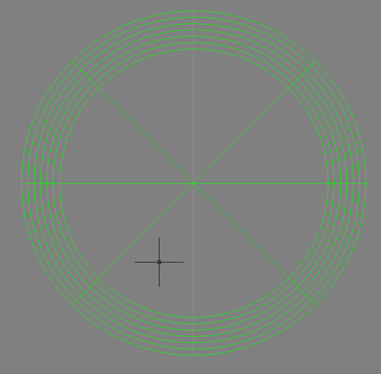

I drilled the outside edged with 8 holes after printing a wagon wheel at a 1:1 scale as a template, I could have done this with the CNC, but it would have required a tooling change that I didn't want to deal with.

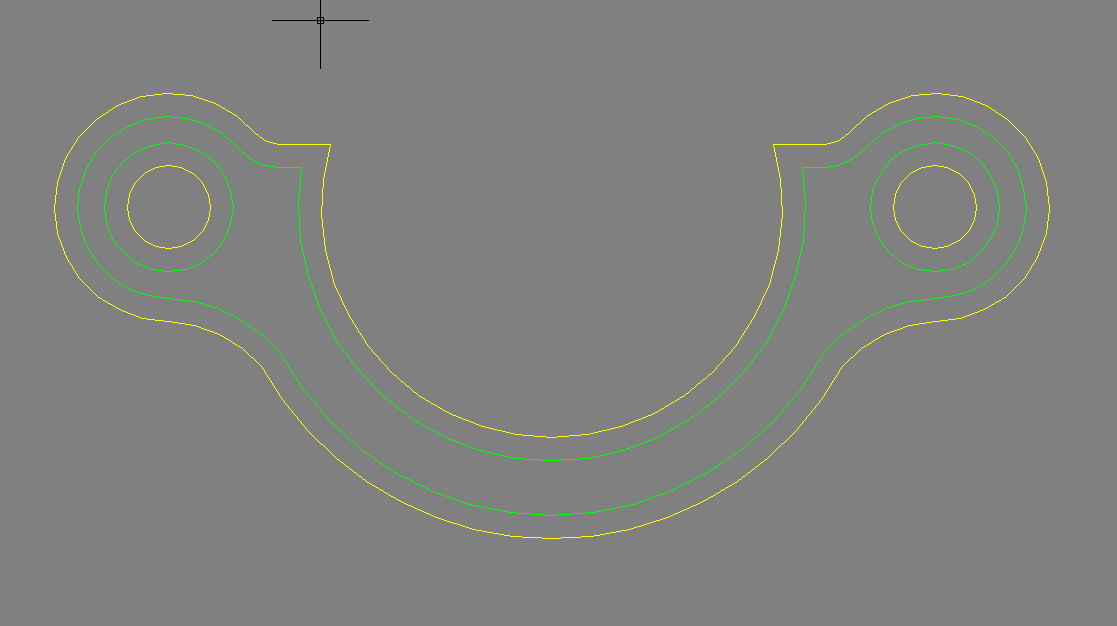

I then cut out the LED mounts for the front, it is just glued to the main pipe. The yellow line is the tool path, for a 12.7mm (1/2") bit.

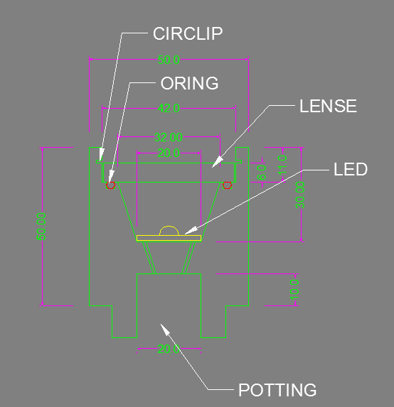

The LED's are set into a aluminium housing that is shown in section below. I have glued the LED to the housing using a heat sink glue, the lens (6mm perspex) presses down on an O-ring and is all held in place with a Circlip. The deeper it goes the more pressure on the O-ring. The light assembly is just held in place by an interference (tight) fit, i may machine the rebate in the light housing deeper and use a circlip to hold it all in place.

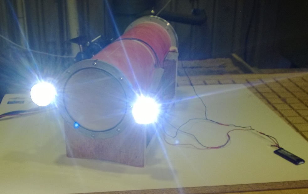

Here is a photo with the LED's lit up.

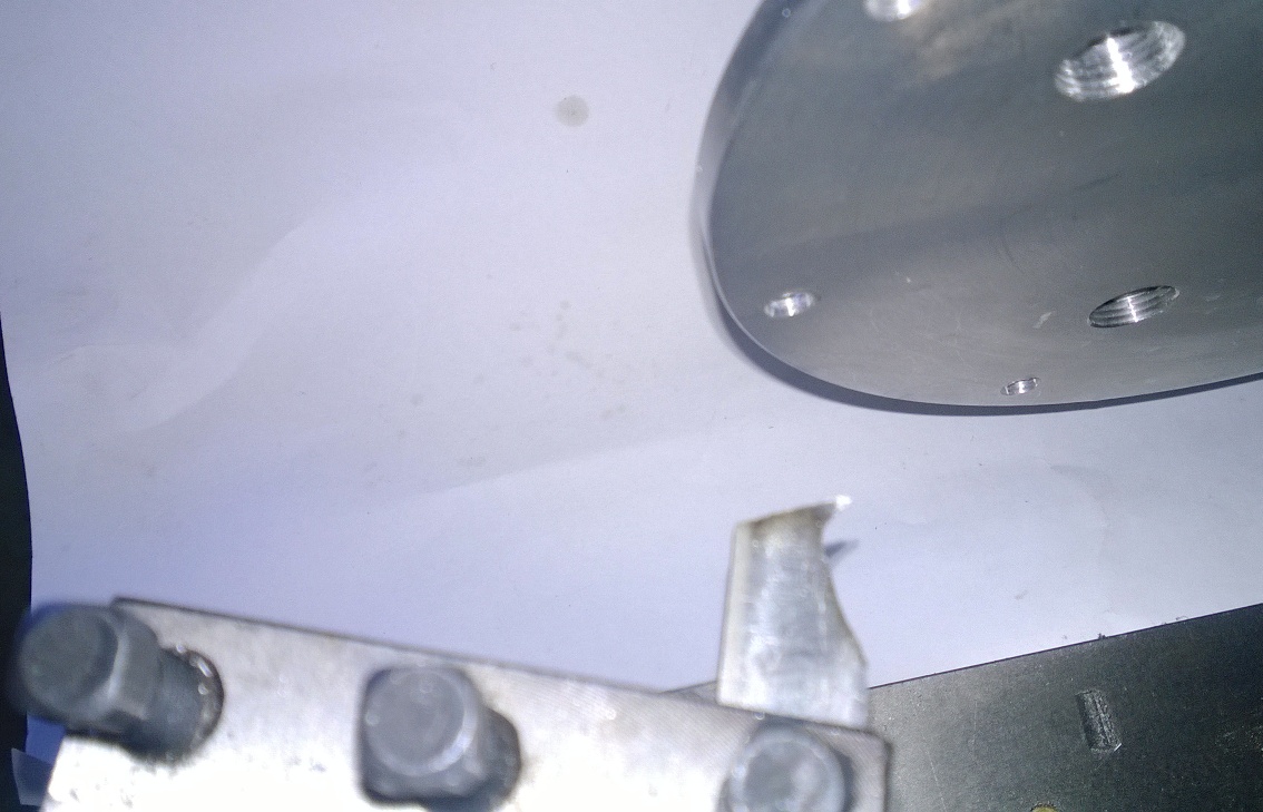

Very neat design and build kenl, one question how are you cutting your circlip groove?
kenl
Posts: 153
Re: My ROV
Post by kenl »
Thanks for the comments guys, it's a lot fun building this, wish I did it years ago.
@jonnyhas I have ground a tool especially for the job, the tool is ground from a broken electric plane blade, which is about 3mm (1/8") thick HSS and say 1/2" wide. For light duty tools that require heavy grinding this stuff is great, any saw sharpening place would have broken thicknesser blades you could have.

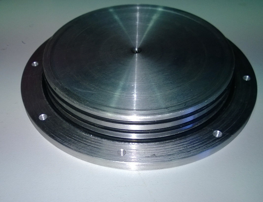

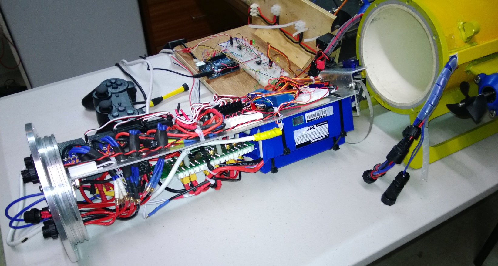

The back door of the ROV is made from a solid chunk of aluminium, I have machined it round and put 3 o-ring grooves in it. Two of the o-rings go inside the housing and 1 presses up against the end of the pipe. The reason aluminium is used is because I am concerned about heat buildup from the ESCs.
During some of my Thruster testing I managed to overheat an ESCs causing it to cut out until it cooled down, I don't really want that happening underwater. I have also ordered some small cooling fans for the ESCs.
My support slide that has all the electronics mounted on it is also aluminium, the cooling fin so to speak.
With all the electrical bits and batteries attached to it it looks like the inside of a missile, posting photo's like this could spark a visit from the terrorist police. :lol:

Here's an interesting thought I had: The submarine guys have boat motors that are actually water cooled. I wonder if there is a way we could run some tubing through the motor housings using the outside water to just cool the motors without actually submerging the electrical components.
If they weren't so expensive I'd give it a test.
Alternately you could build a max input voltage limit on your software once you determine the most comfortable operating range. Kind of like a software rev limiter, you know?
kenl
Posts: 153
Re: My ROV
Post by kenl »
The motors themselves are not a problem, I in fact do have them running in a solution of water and soluable oil.
It was the ESC that got hot, I do recall seeing water jackets of some sort for ESCs but would not want to risk a hose blowing off or bursting inside the main housing.
The software already has some limiting on it, I think it needs more, not due to overheating though. I've had a few test dives, and this thing is too fast... :)
Re: My ROV
You certainly don't muck around, Ken - that's good news about the test dives. The thrusters sound like they are capable of moving a much draggier ROV, but better to have too much rather than too little power. I've considered a "turbo" button that selects flat-out speed range, with normal or low speed range being the default. High and Low range is another way to look at it. If you are working in currents then maybe a range of ranges could be the go. If you can do it for 2 speed ranges then more is not a problem, just have to get accustomed to what "gear" you are in. Do not know how the software you are using is written, but assuming it is Arduino should be pretty straightforward to add in an IF statement that checks whether the turbo button is pressed or not and send different numbers to the ESC part of the program. Things can be refined once you've done that.
If you find the ESC cooling an issue, maybe consider inverting the ESCs so that the fins are contacting the aluminium chassis, and use some heatsink compound, thermal paste of whatever if you think it required. Check whether the heatsinks are electrically isolated from the power and motor wires first. If checking for isolation scrape off the anodising as it is not conductive. You may know this stuff already, but lots of others read the forum too. Don't be afraid to ask for help with any coding, I know at least of 2 of us will be keen to jump in :D
