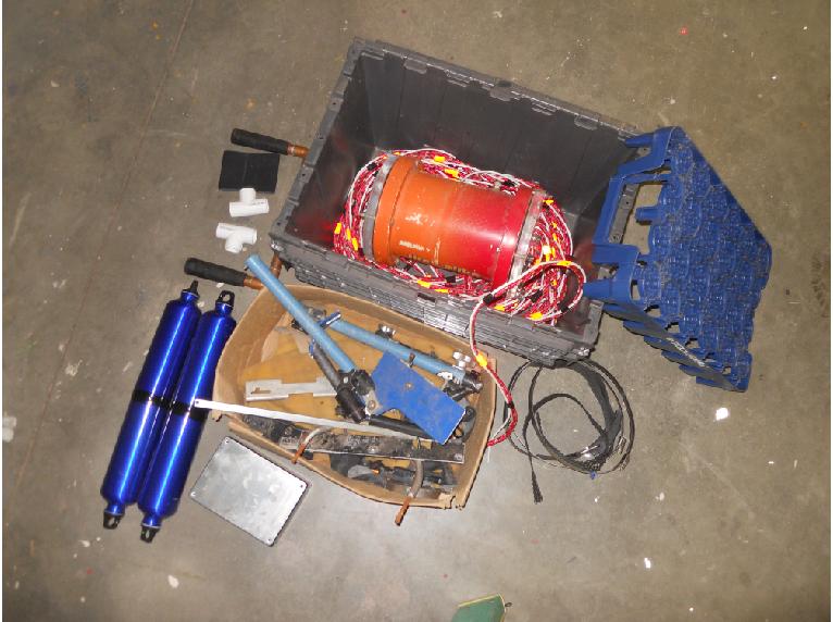

I'm starting a winter project and want to build an ROV for our Dive Rescue/Recovery Team. I have plenty of parts from other projects that I hope you will guide me in using!
1) Since I bought a GoPro I have no need for my old and bulky video housing. She's solid and watertight.
2) Years ago I built a DPV with two trolling motors that I will use again. The unit worked (had trouble with off/on switches though which I'll ask about later!) but was made from a wooden hull that eventually leaked too much to bother fixing.
3) An underwater comm unit tether for a full face mask This I think I can use if I have onboard batteries. Maybe need to add another wire or 2? It is a floating rope with one phone wire attached.
4) There are lots of other fittings, clamps, boxes, arms etc. that I have already as well.
Any suggestions will be greatly appreciated. I realize this is already going to be big and heavy but that's OK, I'd rather overkill a bit. If I can prove the concept and show how valuable of a tool this can be for us I may be able to build or buy a better one in the future.

- rov parts 2.jpg (49.79 KiB) Viewed 5448 times
- rov parts 1.jpg (67.89 KiB) Viewed 5448 times

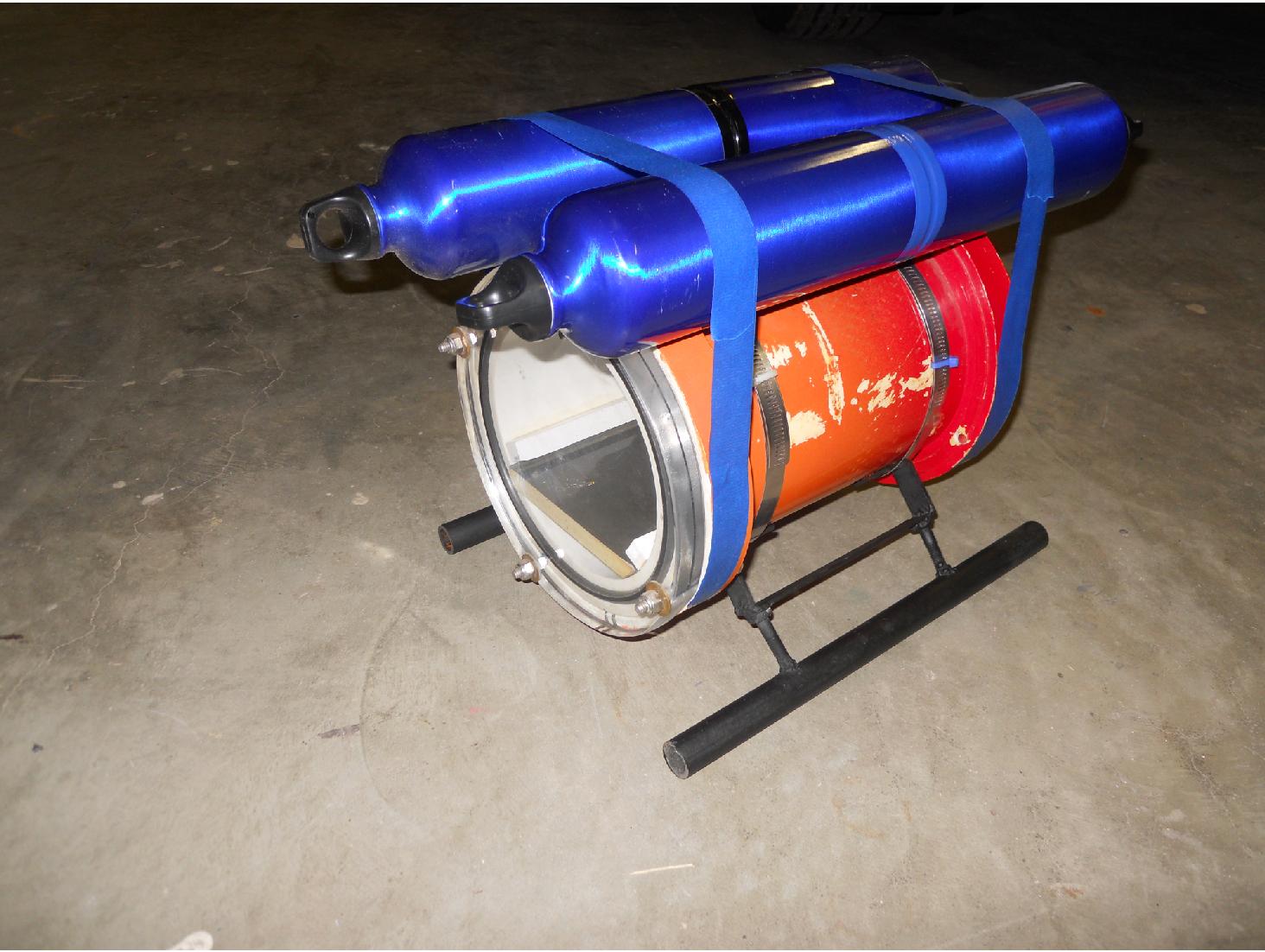

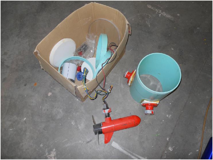

OK so I've made a few decisions that I hope will move this along. I made the skids over the weekend.
Next I'll make a front piece that will hold a scuba depth gauge and compass. I'm only using the old video camera housing with bilge pumps, not going so big as to use trolling motors. I have one bilge pump already that will be for vertical thrust and am going to buy a pair for forward/reverse/turning. The housing can handle at least one of my 12v, 7ah batteries and the camera.
Obviously the floats are only there for example. I most likely will not need that much buoyancy. I will get a dome for the camera side and can extend the back if necessary. Most likely I'll use dive lights for now and they won't need to be wired in (maybe in the future).
Thoughts?

- rov parts 3.jpg (172.15 KiB) Viewed 5393 times

Looks like you're off to a good start with that box of goodies! Just wondering why add the complexity of adding a dome when what you have already works?
3 thrusters is what I used and found limited things. Next ROV will have more. Making another 2 is no real extra work once you're set up and worth doing IMO

Thanks Ross! So first you'd go with two vertical thrusters? I thought about the dome too. I want to get it eventually (may need room to upgrade things, and they just look SO cool!) but won't need it to get this going so you are right about that.
Can I get enough from two phone cables to control the motors if the battery is on board, or will I need a Cat5?
