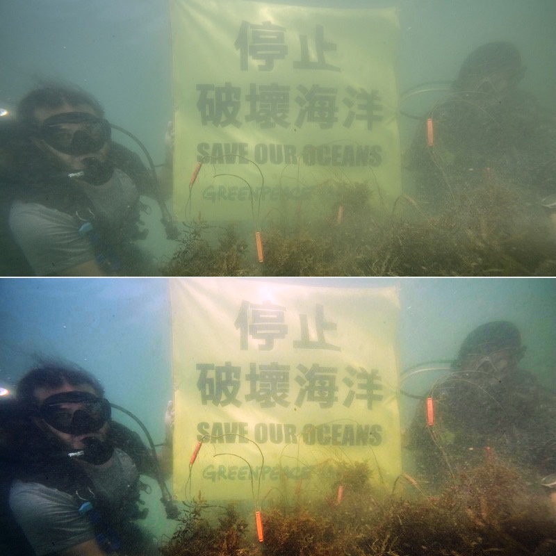

"Muddy" in this case refers to an abundance of fine particulate matter that is evenly dispersed throughout the water. I wanted to show you an example but I couldn't find an image that showed quite the conditions I'm imagining - the one attached is close-ish and I felt it was appropriate content-wisefryslan76 wrote:Define what you mean by muddy water

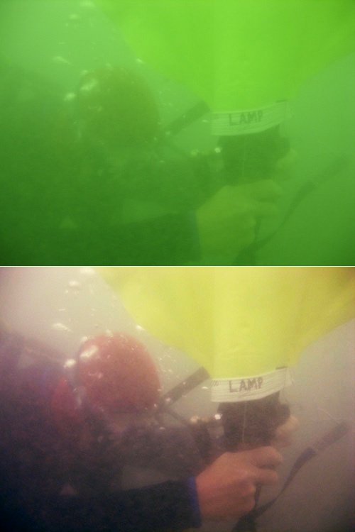

- Example of basic demurkification using curves and colour balance in Photoshop
- demurkification.jpg (153.3 KiB) Viewed 51381 times

Here is another example, similarly processed. As you can see it is quite possible to extract neutral-ish colour information even though the original image has a heavy green cast.
- Another example of what can be achieved with simple curves and colour balance adjustment.
- demurkification II.jpg (58.34 KiB) Viewed 51379 times

Yeah, as I mentioned in my post it wasn't quite what I was looking for but a) it had some objects in the image and b) having a sister-in-law who is a marine biologist and fisheries expert I know only too well how important the message on the sign is. I'm having a surprisingly hard time finding any still images through Google image search that shows the severe murkiness I'm looking for - I suppose most people wouldn't bother posting such photos on the web. The second example is perhaps a little bit better.fryslan76 wrote:Hmm, this is not what i would call muddythis is rather clear still.
