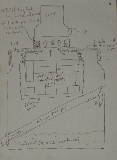

Re: Retrieving sediment from top layer of seafloor
Hi Patricia.
Maybe a small thruster, rated to that depth, inside the suction pipe. You could make an adaptor out of PVC plumbing fittings to suit the thruster diameter if the pipe itself is too small. Use a bigger area filter than that shown in the picture, and place it across the top of the drum.
I'd be keen to see some pics and other details of the ROV project, and I'm sure others on the forum would be too.
Cheers,
Ross
Hi again Patricia.
Small thrusters are available whose specs claim are suitable for that depth/pressure. Do a google search for "ROV thruster depth". Instead of using the thruster as a thruster, you would be using it as a pump, fixed inside the suction pipe. Bilge pumps would probably be crushed at that depth, or would leak water in and so not operate very long. Having said that, modifying a bilge pump by oil-filling it (oil not being compressible) could be a cheaper solution, but you would have to get your organisation's engineering department onto this, as there are potential hazards involved if not done properly. Depends on your budget - $100 with free engineering help - or maybe $1000 for the thruster. Whatever you do, you will need some sort of strainer or mesh over the end of the pick-up tube so pump or thruster would not get clogged up by anything bigger that what you are aiming for. Also, consider the power requirements of pump or thruster (connection to ROV, available voltages etc).
The filter at the top is better being bigger because there is less risk of it clogging up too quickly. Being across the top of the drum will help this also, I would think. Just thinking about that, you could put the fine filter part way down in the drum, and put the thruster or bilge pump in the lid. Can do you a sketch if you like.
You have to work out the wet and suspended volume of the "snow" then come up with a drum size. Plastic screw-top drums are available from beer home-brewing shops. In Australia, they sell 60 litre ones.
Ross
No worries Patricia - maybe just acknowledging the forum in your project, whether you use anything from here on not, would be good.
There are a few unknowns involved as I see it:
Sample material size and therefore what filter type.
Flow rate of pump required.
Just how to oil-compensate a suitable pump.
I would be going for the largest bilge pump flow as you can afford. 2000 GPH sounds better than 500. Note the current draw though - make sure power on the ROV is up to it. Not having had anything to do with bilge pumps other than in their designed application myself, maybe others on the forum have tried pressure-compensating them or know of ways to do it. Any ideas guys?? Something like a "shop-vac", but rated to 1000'.
Refer attached conceptual sketch of what I was describing earlier. Once again, get someone suitably qualified to do any mods to the pump, cutting holes in the drum etc if you decide to go this way.

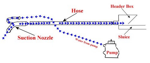

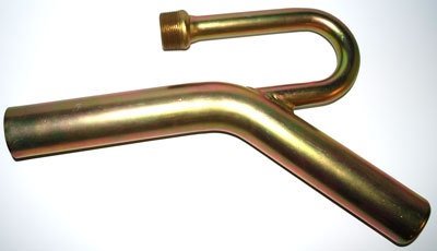

Post by captcrunch81 »
This is way easyer than u think it is. You need a small dredging nozzle. A small pump will work for what you are trying to do with it. Here's a pic to help explain how it works
