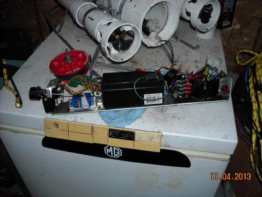

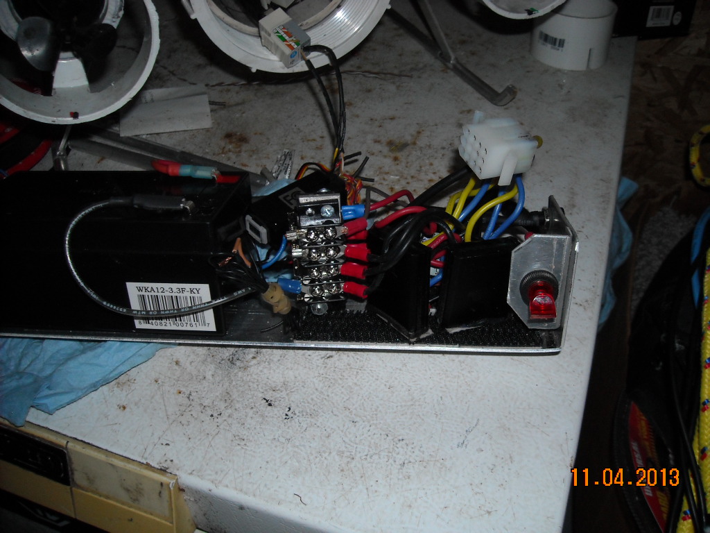

Some picture of the Electronics. Camera with servo for tilt, Battery 12v 3.3ah, Power dist block, and Speed controls (Viper 15 amp reversing water proof)

I like the camera tilt mechanism. I had a similar idea for a RaspPi camera since you can easily turn the ROV to see left/right, but the tilt is a bit more difficult.
I see you're going with lead acid type battery. Have you read up on them? I don't know if they're recommended for enclosed spaces. I think they 'off gas' when they're running and therefore shouldn't be kept in a sealed container.
I don't know this from personal experience, but I did think that was the reason people generally go with Lipos.

Re: ROV Without a Name
Thanks
The camera came with a pan and tilt bracket so it was easy to configure at least for the tilt and like you said move the ROV for right to left.
The battery is a gel cell no vents in he battery completely sealed so should be no off gassing.
