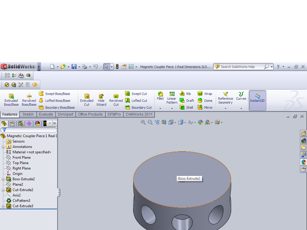

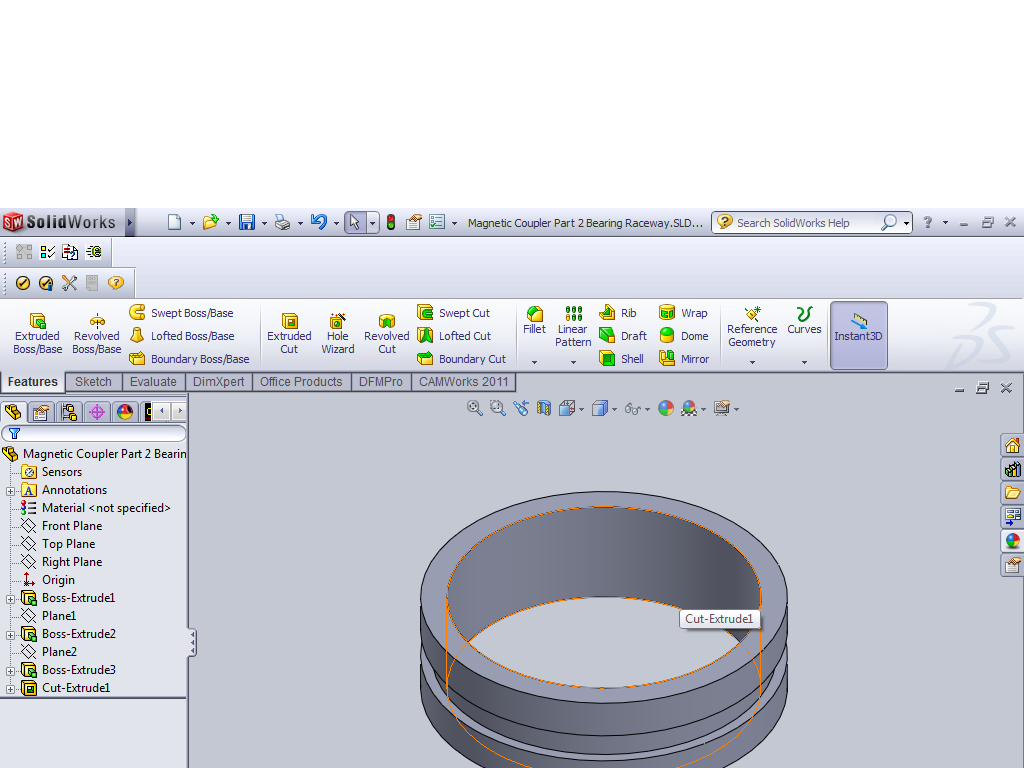

I'm a high school student making magnetic couplers in a CAD class in school, and I can then 3D print them, which in all honesty still blows my mind. I'm creating something very similiar to Bigbadbob, except my magnets are bigger, with 6.5 pounds of force each, with up to 8 on each motor. I am also using ball bearings between outer ring of magnets, and what my motor is housed in (orange pill bottles, which will be sealed up). I also have a much more aggressive propeller. I hopefully can provide updates for you all when my parts are printed(there's other people in my class who have to print before me, and there objects are much larger)!

- Full shot of part 3. The cylinder with the notches at the top is where the propeller is attached to.
- Part3 View 5.png (192.21 KiB) Viewed 5168 times
- Part 3, which is what my propeller will be attached to, driven by the internal magnets. This is a split view, showing the internal raceway for the bearing balls and the holes for the magnets.
- Part3 View 4.png (188.52 KiB) Viewed 5168 times
- Part 2, which will be stationary on the outside of the housing. This is the raceway for the ball bearing
- Part2 View 1.png (136.1 KiB) Viewed 5168 times
- Part 1, directly spun by motor in housing. The tag accidentally covers the hole in the middle where the motor shaft goes.
- Part1 View 1.png (120.02 KiB) Viewed 5168 times
