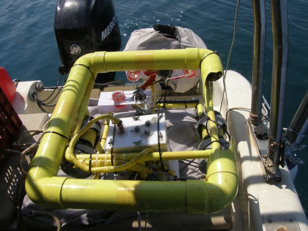

Yet, this summer I managed to make a few dives with the ROV and I also managed to destroy it 2 or 3 times.
Anyway, I learned a lot through these dives about the equipment and its behavior underwater.
After our initial testing to 14-15m, (https://www.youtube.com/watch?v=KAT13i_dbgI) and after re-sealing the fuses in the battery box, I was pretty sure that all will be OK at least to 20m.
So, on our first dive at the end of July we had a blown up buoy at 17m! (See photo).
The buoy was made of hydraulic PVC pipe (Ø75mm – 6Atm). Obviously the 6Atm pressure must be applied from the inside of the pipe, not the outside!
The next day I made a new buoy for 10Atm which made it through the summer and reached at 21m depth without any explosions or leaks.
After that, we made another dive aiming at 20m. At 9m the U/D motor failed. After a little search, I discovered that the DPDT relays were not responding to the orders of the switch. I concluded that they had been burned since the load (approx. 5A at sea surface) was close to their capacity (8A). So, I thought, at 9m depth, the loading is higher and the relays failed.

We tried it at 21m, and at this depth the bottom camera failed (something about the wiring) and the battery made a short-circuit burning the wires, and most probably the relays. All in one dive!

I also decided to change the frame (copper pipe) because it is too big for my needs and too heavy (6.5 kg). I’m thinking of making a new one either of Polypropylene (http://www.borealisgroup.com/pdf/litera ... _10_BB.pdf) pipes (I can’t find PVC pipes of small diameter in Greece) or Aluminium.

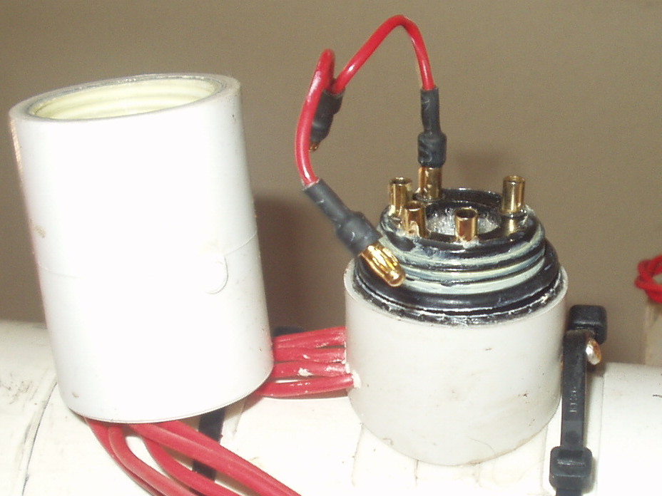

I made a separate charge connector which can be opened without risk of the main electronics getting wet. Made from a garden tap adaptor and a threaded coupling from the hardware store. Bullet connectors (left over from HobbyKing speed controls) are potted in place, but I noticed that some of the connectors had a hole in the side, so was careful not to let epoxy run in. The mixed epoxy I had left over I tipped into the coupler to seal the other end. O-ring and grease are visible. Sealed well, but would not use this approach on the main hull

Cool. Was just showing that a separate enclosure or waterproof connector for charging (and in this case a basic means of power on/off switching) is preferable to opening the battery/electronics enclosure each time you charge. I've used the O-ring as a sealing washer, not how an O-ring is designed to function, and only down to about 4 or 5 meters, the water depth where I have been testing. Also, the main hull shown elsewhere on the forum uses cheap drainpipe (maybe like your old buoyancy!) screw fittings and only suitable for a few metres.
