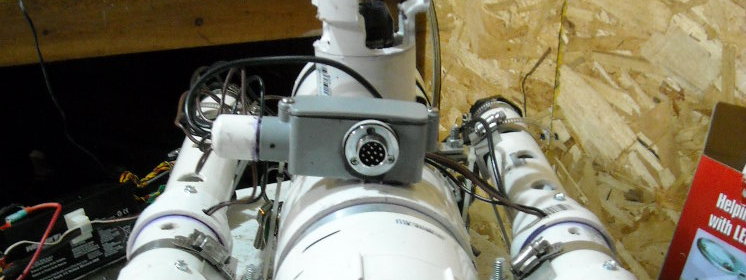

Re: Spektrum DX5e 2.4ghz / .10 Brushless motors / 30amp ESC/
Bikerbones
Did you attach your tether with the same external exposed bullet connectors that you showed back in the beginning of this thread?
I used a 12 pin male/female that I attached to the ROV so I could disconnect the tether, but as my ROV was in the water all the speed controls got real glitchy, so I pulled the DSC wire out of the receiver and the ROV ran perfect off of the antenna, mind you this was a test run at the dock in 3-4 ft of water. I will have to dig into it yet but was wondering if you had any problems and if your connections had gotten wet.
