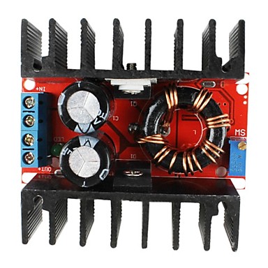

Are you planning on running both LEDs off of one step up PS? I think you mentioned that the step up that you have will handle 3A?
Re: Bridgelux 1100 lumen High Power LED's
Yes. Both LED's are running off the one step up converter, and it is rated at 3A.
I got the step up converter on eBay, and I usually only run things from eBay to about 30% to 80% of their rating, but this board is high quality, and has active voltage monitoring so no matter what your input voltage is, it will output the voltage you select. So far it is a great board.

Does it happen to look like this? I have this for my setup and it works excellent.
http://www.ebay.ca/itm/2x-150W-DC-DC-Bo ... 1c35b6d343
- DCDC STEPUP.jpg (43.33 KiB) Viewed 19384 times
Yes. That is it exactly.
