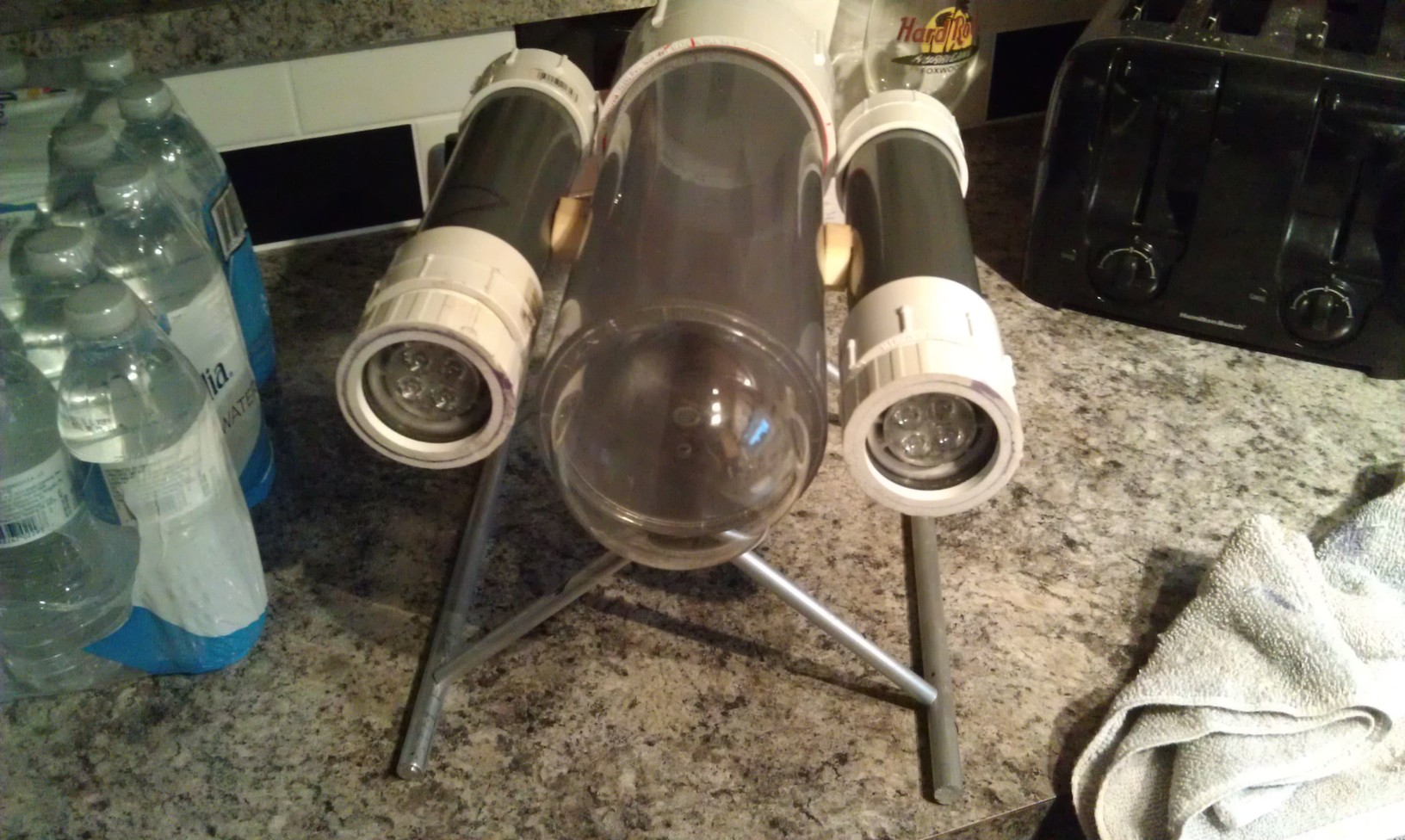

Demon340
Posts: 34
Joined: Aug 7th, 2012, 6:06 pm
Location: Rhode Island
Actually looks like something now
Post by Demon340 »
Got my side pods mounted, and yes its tilted to one side, the pods are pretty darn straight for eyeballing the holes. The carriage is crooked but I'll straighten that out shortly. I have the pods mounted with male/male 3/8" pipe fittings for my wire pass thru. They will be pipe taped on the threads then polyurethaned or epoxy resined around edges to ensure water integrity. I have chunks of syntactic foam in a oval shape over the top of pipe sandwiched between the two parts on both sides for aesthetic appeal and strength once there all glued together.
