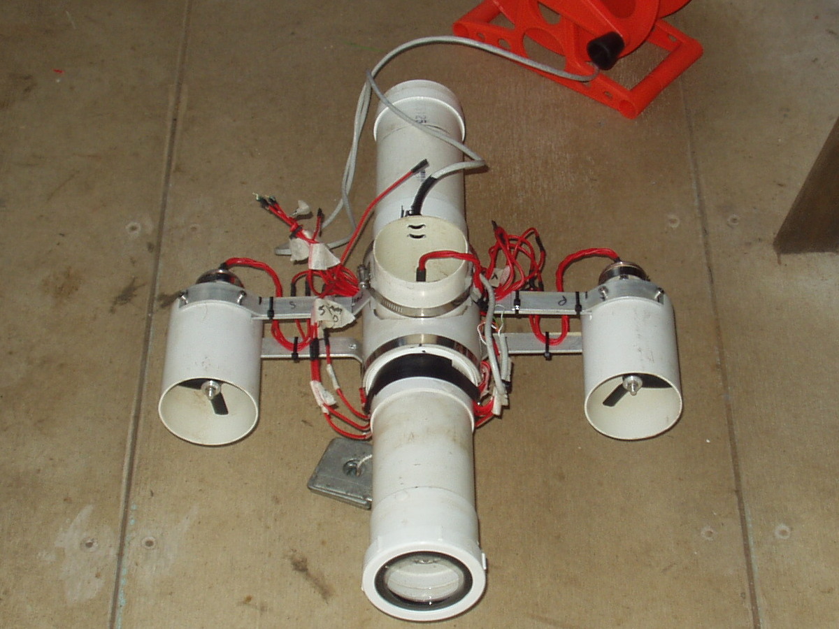

Northwind, just so happens that yesterday I did the first water-test of my prototype ROV, and I am using the same motors as you linked to. Running off a 7.2V ni-mh 3300mAh, and turning Turnigy 5030 props cut down to about 75mm diameter, I would guess at 1m/s but certainly not more. Lots of draggy appendages in the form of brackets and wires, and the vertical duct/shroud, though this and the port and starboard prop shrouds and hull are 90mm stormwater drain. Overall length and beam 620 by 490. I do not think a Seabotics http://www.seabotix.com/products/lbv150-4.htm type hull would do 3 knots with these motors, but something of smaller cross-sectional area, properly streamlined, certainly would. Sorry no video but some stills..
- rovfront.jpg (169.73 KiB) Viewed 27866 times
- rovtop.jpg (251.93 KiB) Viewed 27866 times
Re: Topside Battery
Well done Rossrov. That looks great. You've just given me great confidence to proceed. Look forward to seeing more. Thanks

Hey Ross,
Looks great! I like the props!
How did the forward vs reverse thrust balance out?
Don't suppose you checked how many amps you pulled with the motor running in the water?
Again, congrats on your first sucessful dive!
