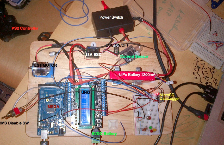

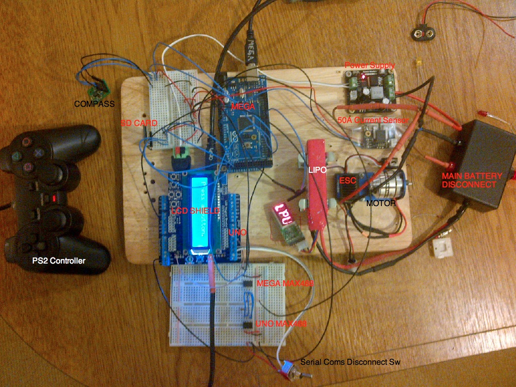

As promised, I spent some time today playing with some code and generally making a mess of my flat!
I actually achieved a pretty major milestone today. I was able to control the speed/direction of a motor attached to one Arduino (MEGA) via inputs from a PS2 controller connected to a second Arduino (Uno).
In the picture, you will see my current test set up.
KR2_ROV Layout April 2013
Small Layout.jpg (248.55 KiB) Viewed 24885 times
The datalogger code is right from the tutorial on this site.
The serial coms is based on the EasyTransfer code from Bill Porter. (Same guy that wrote the code I'm using for my PS2 Controller!)
(website seems down at the moment...)
Once I get my code cleaned up and properly commented, I will post it on here.
I also ordered the some of the sensors I plan on integrating into the ROV including:
1: Digital Temp Sensor
1: Tilt compensated Compass Module (I2c)
and a new TFT display shield for my top side controls.
Making a mess of the flat!

AHarris
Posts: 152
Joined: Mar 14th, 2011, 1:45 pm
Re: KR2 ROV
Post by AHarris »
It's looking very good, an impressive setup to say the least!
Don't worry about the mess, all great inventions and ideas come from a cluttered corner of room.

I have been working on my code recently, and I am ready to post an update.
Here is my current set up:
Current Control Setup
ROV Layout2.jpg (327.83 KiB) Viewed 24857 times
Arduino Uno (Surface Module)
1- PS2 Controller
1- LCD Shield
1- MAX488 IC
1- SPDT switch
1- Power Supply
Arduino MEGA2560 (ROV Control)
1- Micro SD Module
1- 50 Curent Sensor
1- MAX488 IC
1- Turnigy 18A ESC (no longer listed on Hobby King. Hope it is replaced soon!)
1- 11.1V 3S1P 1300mA LiPo Battery
1- Disconnect switch for LiPo Battery
1- Tilt Compensated Compass (no code in program yet...)

So. With this code, I am able to input the speed and direction of the motor (connected to the MEGA) via a PS2 Controller (connected to the UNO). If you run the serial monitor on the MEGA, you will see the XY values for the PS2 Controller, the zone (used in vectored thrust control), and the current draw on the main LiPo Battery. This data will also be replicated on the 16x2 LCD connected to the UNO.
Basically, all of the code is here to build a complete ROV setup. Some copy/paste and renaming of variables may be necessary, but this is the core of my program. I have no problems with you copying and using it. I would however appreciate a mention should you post it anywhere online (and a quick courtesy e-mail / post would be nice too!) I have spent countless hours getting the code to this state.
I would like to thank Bill Porter (again) for the libraries he created for the PS2 Controller Library and the EasyTransfer Communications.
Enjoy!

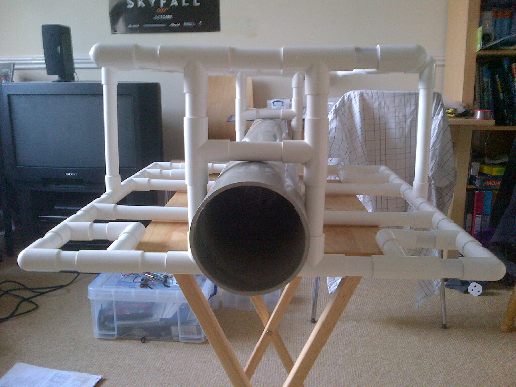

As promised! I worked with a friend today to build the frame! All in, the components were about 60 GBP, but that was with a staff discount at a local diy shop. 60-75p per fitting and 4 GBP for the lengths of pipe.
Later this week I will be bringing it to the pool to check if it is water tight (which I have been assured it is!) and to do some buoyancy calculations.
Overall Dims: 63cm x 57cm x 26cm
