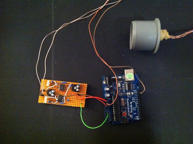

gumma wrote:Greetings!
- pressure (and depth) sensor + temperature sensor
Hey Gumma!
How is the build going!?
Just curious what you used for your pressure (depth) sensor? How did you mount it? Is it connected to your Arduino?
Thanks!
"KR2_Diving"
gumma
Posts: 49
Joined: Jun 1st, 2011, 4:05 am
Re: ROV from Croatia
Post by gumma »
Not so good, i'm renewing my flat so i moved away for a month. I hope i will be back to my work shop next week. Anyhow here's the pic, i think i posted it already. The pressure sensor is connected to differential amplifier (5V power supply). Sensor is powered with 1.1V via arduino. The pressure sensor is HSF1000-TQ (http://www.hoperf.cn/)

gumma wrote:Anyhow here's the pic, i think i posted it already.
Ah Yes! I remember now! (And I looked again and for the thread!)
Sorry for asking the question twice, but thanks for reposting!
Hope the move is going all right!
