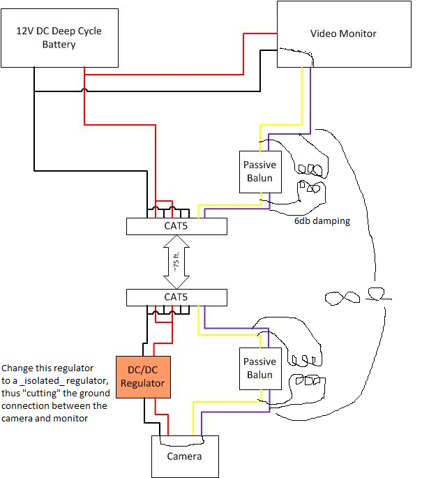

1.Does the camera has common ground between power and signal?
2. does the video monitor have same ground as you power the camera ?
3. Is the screen from the balun connected to anything except from the monitor.
I think you have a nice ground loop(or lack of good ground). the signal from the camera is transformed to a diffrent impendance then transfered back to normal video impendance. this function in addition to convert the impedance, also isolate the signal and ground between the to sides.
when you run the camera trough a wall adapter the ground of the camera(and screen input of balun) is separate to the ground of the output of the balun( and the input of the videoscreen).
when you then connect these to units together on the same powersupply and then getting a common ground on both topside and down at the rov, the ground power go mostly trough the power wires, and is then not related to the balun.
fix? Isolate the power and ground to the camera at the rov. you get small isolating DC/DC converters on ebay. cameras usually dont need that much power, so you can get a small converter for this. (http://www.tracopower.com/category/dc-d ... l-purpose/)

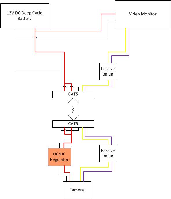

I attached a quick drawing...the purple ground line is the jacket or ground of the BNC connector. I have tried with both the purple connected/unconnected to the black - no real difference.

So to confirm: if you leave the system as now, but power the camera from a wall outlet, the picture is "perfect"?
the dc-dc regulator and filter you got, is not isolating the ground between the camera and the video monitor.
you need a isolating dc-dc converter to fix this most likely. or you skip the baluns and try the camera directly over cat5 ;-)(probaly worse, but worth a try)
if you measure resistance between power-ground and the coax-screen on both the camera and monitor you will see that this is the same common point. but you will not get any resistance measurement if you would measure on just the balun connected with a cat5 cable inbetween. the baluns isolate the signal.
because of the signal is going trough the baluns, this signal will be dampened- about 6db usually. Since you have a perfect copper cable without any obstructions between the camera and the video monitor, the balance between the battery ground, and the ground coming out of the balun will be diffrent - thus disturbances.
i've tried to illustrate this with a really bad drawing attached.
the reason everything works with the wall adapter is because you separate the ground on the camera from the rest of the system.
Uten navn.png (80.99 KiB) Viewed 6596 times
