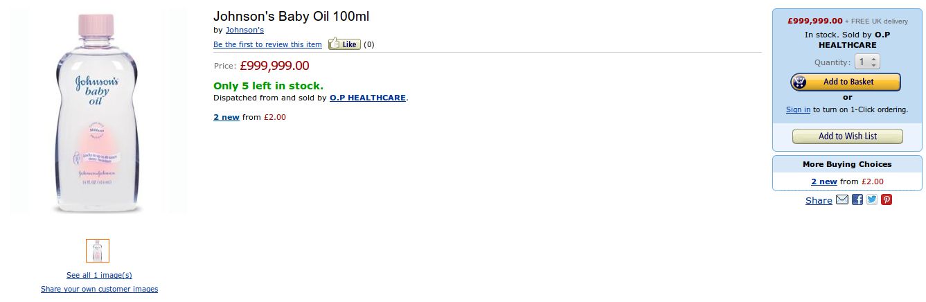

Whilst attempting to find some cheap mineral oil which I could use to fill my electronic and camera enclosures, I happened to come accross this bottle of Johnson's Baby Oil on Amazon.
I can assure you, this image hasn't been edited in anyway:
Re: Poseidon Mk II
lol
awesome
how many you gonna get???
simpleben77
Posts: 23
Joined: Sep 3rd, 2011, 1:24 pm
Re: Poseidon Mk II
Post by simpleben77 »
you would certainly hope the shipping is free.
Re: Poseidon Mk II
I heard about those! That is one of the Limited Edition Unicorn Drool formulas!

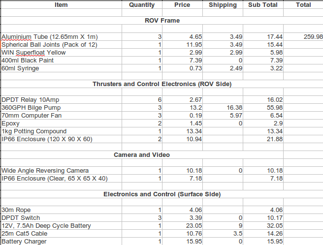

Ok,
Here is the complete parts list, including cost. It is a bit above my original budget (approx £50 ($77)) however with the late arrival of some birthday cards I think it shall be OK. I still am going to look for some areas which I can price cut, however as I say, it is feasible.
Some of the items included in this list are and some aren't on my original post, this is because of changes I have made, and because I already have some of the resources I need.
What sort of prices, if you don't mind me asking, have you lot spent on your ROVs?
