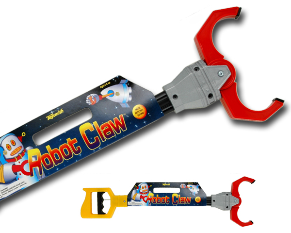

With a simple geared motor setup you can even convert one of these types of toys into a manipulator.
I've actually been wanting to do a quick how to on how to make a simple manipulator using one of these but I've been a little side tracked in life lately.... Soon though.......
