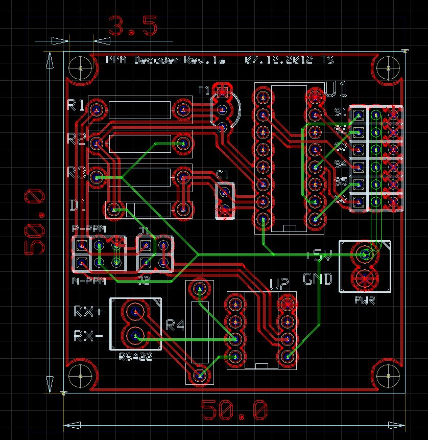

i've searched abit on the net after ppm decoders myself, and found these two aswell:
http://www.foxtechfpv.com/rmilec-ppmpwm ... p-403.html
home made: http://myweb.tiscali.co.uk/norcimradioc ... Radio6.htm
I've made a design of my own on the last, but have not tried it yet, so i dont know if it works. if you want you can get the gerbers to order the board for yourself, i've integrated RS422 capability to have the ppm signal over long distance.
the board is made 50x50mm so you can order cheap at http://www.iteadstudio.com/
- layout.jpg (177.72 KiB) Viewed 5528 times
- schematics.jpg (218.18 KiB) Viewed 5528 times

For more channels on the 4017, i think you must change the values of R3(390K) and C1(22n) to change the timing to reset the counter and connect channel 7-9 to pin 6,9 and 11.
If my calculations are correct and my understanding of the circuit is correct. the framespace(explanation of framespace http://rcarduino.blogspot.no/2012/11/ho ... tream.html http://diydrones.com/profiles/blogs/705 ... Post:38393) is around 8ms, so in your case with 9 channels, this time must be lowered quite low, probably in the area of 2ms. which you probably can get with a 100k resistor instead of the 390k. with a 500k pot you could try to adjust your value, and when you get signal on the ch9 output you have the right value.

i've turned my focus a bit away from this way of controlling my rov project, and have taken an intresst in the openrov system.
but i'm very interessted in knowing if you get the circuit to work! please post an update here.
and to everyone thats interessted in the gerbers to my board - drop me an pm with your email adress and i'll send it.
if someone builds the circuit and confirm it works, i can post the files here in the forum. i dont want to publicly distribute something thats not tested or confirmed...

Hi Fluxno !
Actually ,I built my card with my CAO soft .
I built a pcb particular ,for some test , like :
-acquiring in/out signal for my logic analyser with sub d port ,
-powering with a LT1084 (3A capability )
-external count for test
It is few little modification ,not very important in the conception
but need to do it .
I need to built this circuit today (if I have all the time ) ,
I had never using an engine file like " gerber ",and can't gave any garanty in any compilation (need lot of setting parameter)
cause never experience in this using .
I self-built my usual pcb in my workshop, and I think the best way for everybody here is to give a mask of the pcb online (in pdf )
If anybody interest can modify in compact PCB with cms componant, and servo direct connection without my modification ,but I would like finish mine in first .
I'll give any info when finish.

OUps !
Excuse me, (the alea of my translation error !)
If I think good ,you ask me if your card work ?
I do my prototype on fly wire ,and work good ,and i think yours too.
