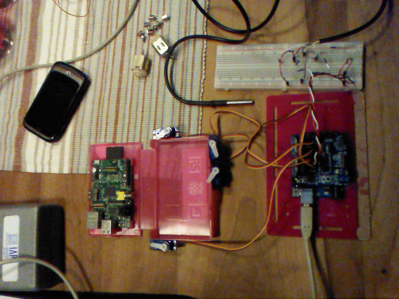

Wednesday the goodies arrived from Hong Kong, so I have been tinkering a bit after work and managed to get a very basis system working. About every second the Arduino reeds the temperature and writes this to the serial monitor on my laptop. The serial monitor can also send keystrokes to the arduino to control the servo's indepenend of each other. Next task is to run it through the Raspberry Pi and put a small gui in front of it.
All the stuff on the breedboard was needed for the temperature senor, I did not have a 4K7 resistor only 1K and 220 ;) The two servos next to each other represent forward backwards and steering the other two represent the up and down motors.
Basic control :)

Looks good. How difficult was it to get the Arduino to communicate with the Rasberry Pi? I have thought about a GUI front end for various monitors like depth, temperature, heading etc.... but have no experience with the Rasberry.

For communication between the PI and Arduino, that is not very difficult. I used the Arduino GUI for linux to upload a program to the Arduino which listens to the serial bus for commands. Sending serial commands through the PI is no problem. See also the link I posted earlier. In the magpi online magazine a updated version is listed and some more details which can be handy.
