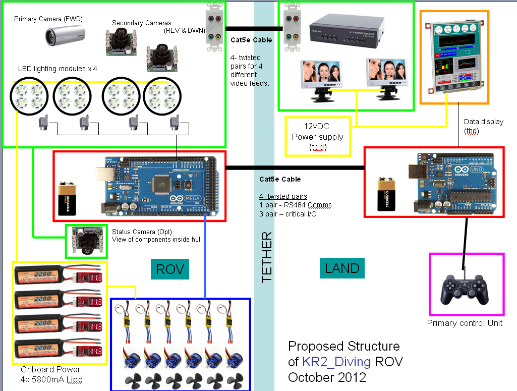

After the initial start, things have slowed down in my progress. Have dived into the deep end of studying each component at length trying to make heads or tails of each part.
I had a bit of time today, so I threw together a rough layout of the components I plan on using. After looking at it, I realize that it may look like a serial killer was paging through a few catalogues cutting out parts at random, and glueing them to the page. But I find diagrams such as this help to show the big picture, and may highlight things I had not previously thought of.
IN my case, I hadn't even considered what I would use to power my land based components... Oops!
Anyway, have a look! Let me know if you spot anything critical I may have missed! If I get time, I may clean this up a bit...

Wouldn't it be easier to use an onboard camera selector (hooked up to your arduino), and just run one cat5e pair to the surface?

probably, but at one point I was considering having a home security style receiver that could record multiple feeds at once, and that would need to be at the surface.
Also, I have not really found a reliable enough video switch that is compact enough to mount in my sub.
I'm open to suggestions!

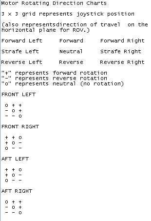

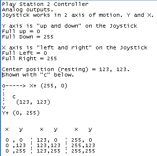

This is where I hit the wall... How can I convert my analog input from the PS2 Joystick, to servo control signals?
The analog in has 2 chunks of data, X axis position and Y axis position. (Both on a scale of 0 - 255). Neutral position (center of joystick) is at 123, 123.
The confusing part is how to I convert this data into an analog output (20 - 180) to control my servo? In other words, how do I get the direction I am pushing the joy stick to correspond with the direction of travel of the ROV?
I have created some tables and diagrams to help understand the principles, but to get full analog control... I am struggling...
Any suggestions would be appreciated.

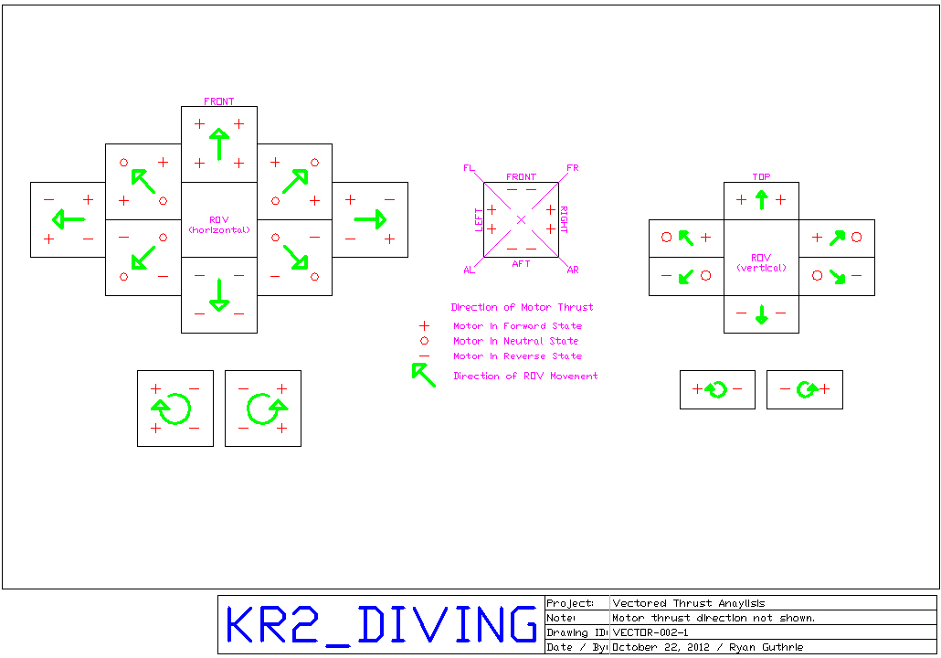

Kinda, but it does not take "Vectored Thrust" into account. The servo library gives me the ability to feed a number from 0 to 180 to the ESC to control the speed of each motor. What I need is the ability to determine what speed each motor needs (relitive to each other) to accomplish the direction of thrust I am commanding (via the joystick).DavidF wrote:I was under the impression that the servo library did that for you???
If I had a basic 3 thruster set up, the servo library would be perfect! However, I had to go and make things hard on myself... I need to control 4 thrusters, mounted at an angle, by one joystick...

Had a bit of an Eureka! moment this week, and got my Vectored Thrust formulas figured out! Beginning to see some limitations to the PS2 controller... not sure if it is my set up, or the controller I have, but the resolution of joystick is not very high... Perhaps this is what I get for ordering a knock off PS2 controller...
Once I get a few more motors and other parts, I will post details. (want to test it in real life, not just code first!)
Ended up splitting the "range" of the joystick into 9 quadrants. Each quadrant has 2 or 3 zones inside of it. Depending on the position of the joystick in the virtual grid, a "zone" is output. (zone = 1 to 21)
That "zone" is then used in a case switch which has the correct motor directions programmed for each zone.
