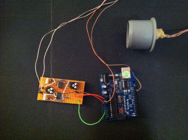

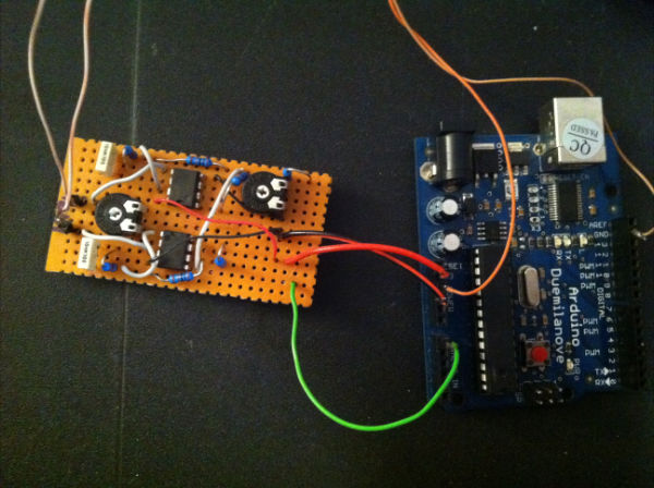

Anyhow, this the absolute pressure sensor connected trough differential amplifier to arduino. Voltage difference from sensor is connected to amplifier, amp output is connected to arduino (green wire). Keep in mind that arduino has 5mv resolution for analog input so you need to decrease it to 1mv resolution using analogReference(INTERNAL); on setup. I still didn't calibrate it, i get around 10 mV difference per 1 bar. There's a trimer on amplifier so there's option for hardware calibration of startup point.

Thanks for the pic! I am starting to get the idea! I assume the grey part in the 2nd photo is the actual sensor. Is only one side of this exposed to the water? It is the mounting of the sensor that I can't quite get my head around now...

Heh, i wanted to shoot the pic inside that PVC but i had to play with my minions..Sensor is inside the PVC, sealed only from the outside (yellow 2-component glue), covering wire contacts. Upper side of the sensor is inside the PVC "cap" so i can plug another 2m PVC pipe, pour water in it an calibrate sensor (to do list).
