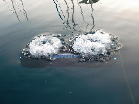

Wow, that is truly amazing ROVER3D. Have you gotten to try it out in the water yet?

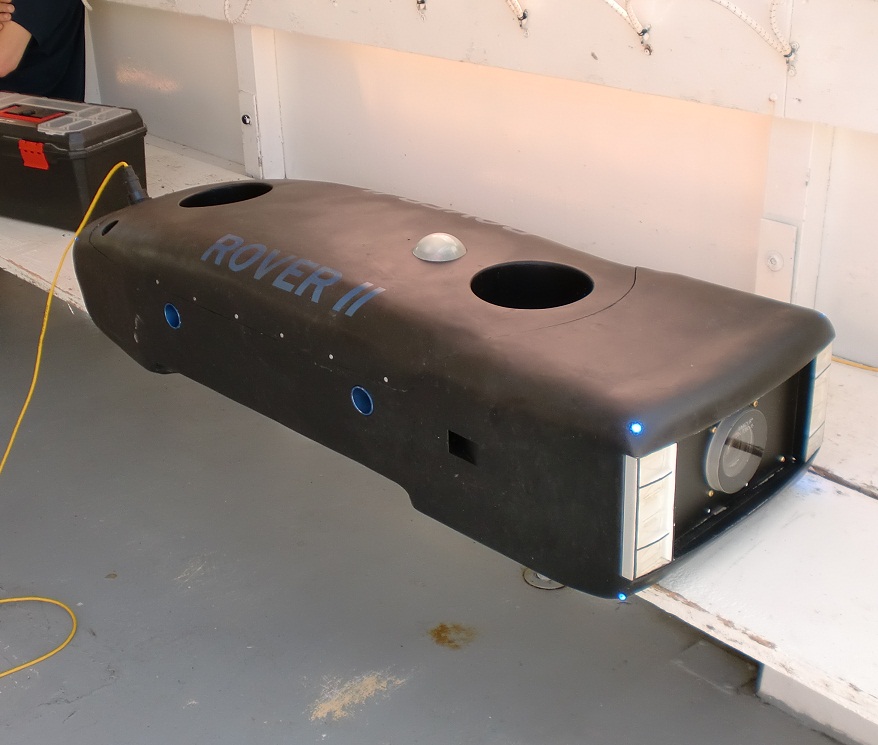

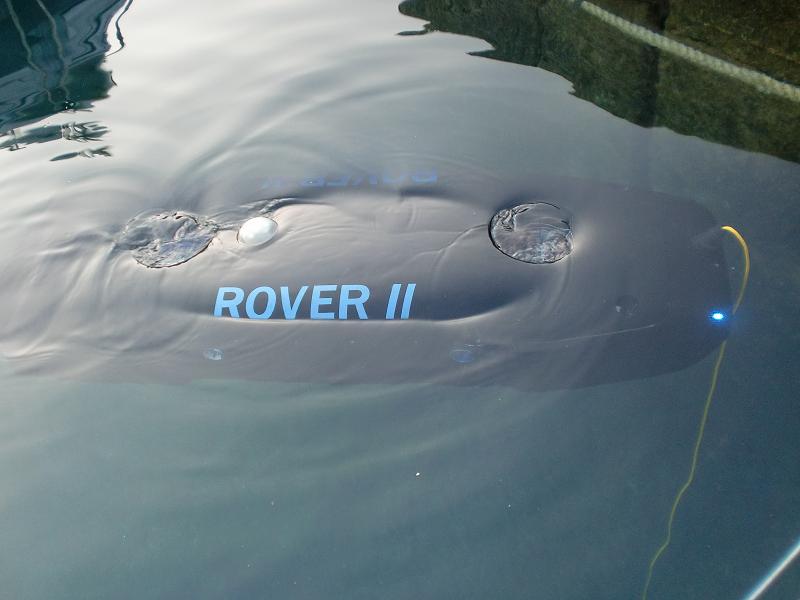

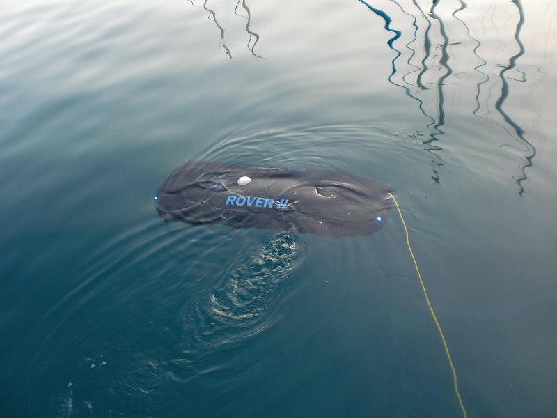

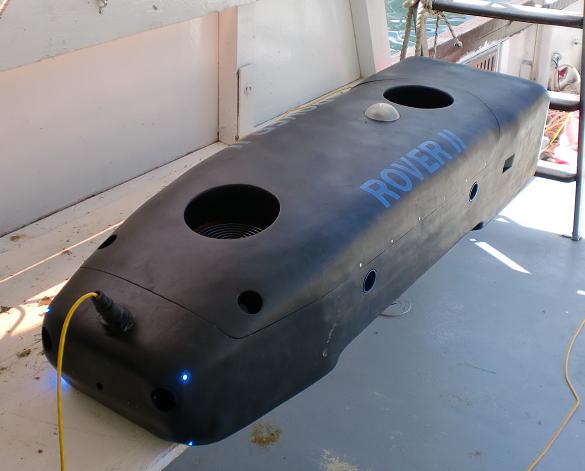

RoverII at Elba, Italy

Dude that's AWSOME!!! How does the hull hold up under pressure?
ROVER3D
Posts: 128
Location: Wuppertal, Germany
Re: ROVER3D
Post by ROVER3D »
The hull does not hold up the pressure. the electronic components build in an oil-filled housing inside the hull.

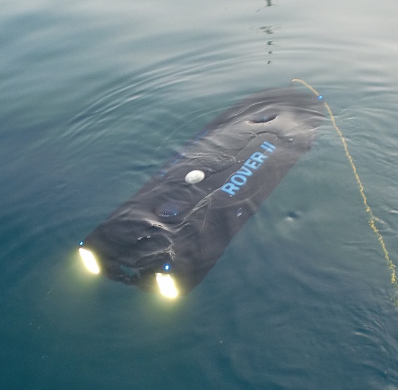

Truly amazing job!! Did you use epoxy resin or polyester resin for hull?
ROVER3D
Posts: 128
Re: ROVER3D
Post by ROVER3D »
thx 8-)
i used epoxy resin. Don´t use polyester! You cannot use polyester in saltwater for longer time, you cannot clean the rov with alcohol or aceton and you may have problems with painting. i had a lot of problems with it so i can´t recommend polyester for rov-building...

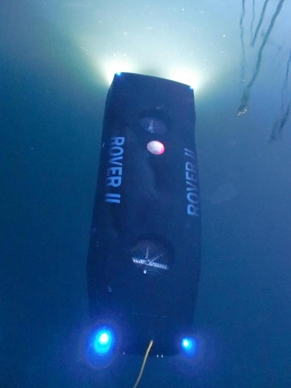

ROVER3D,

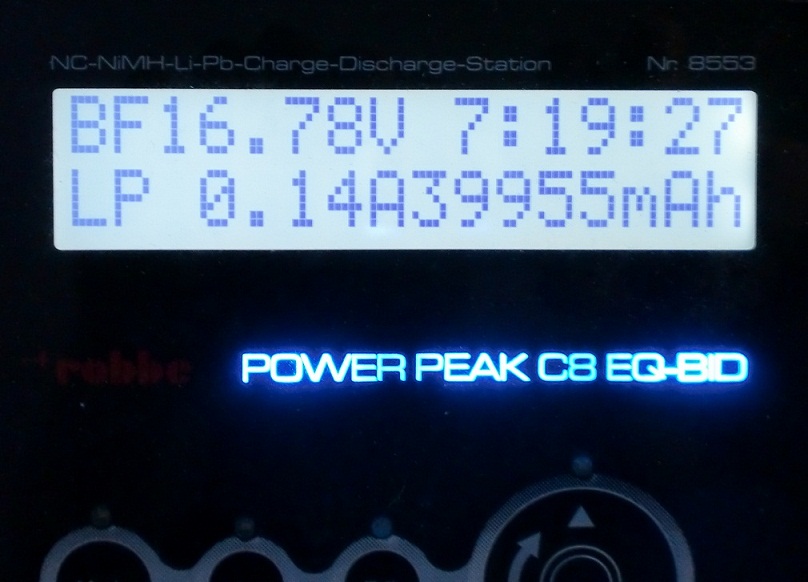

How long can you typically run your ROV with that battery pack?
And how long does it take to charge it back up to 100%?
ROVER3D
Posts: 128
Re: ROVER3D
Post by ROVER3D »
hey olegodo,
this is a very difficult question. whats a typical use?
sure it will run 4h in halfmode.. but my current rov isnt tested.
when i dimm leds to 80% they only take 50% of full-current. so there are many things you can do to stretch operating time.
Loading time at 6A:
