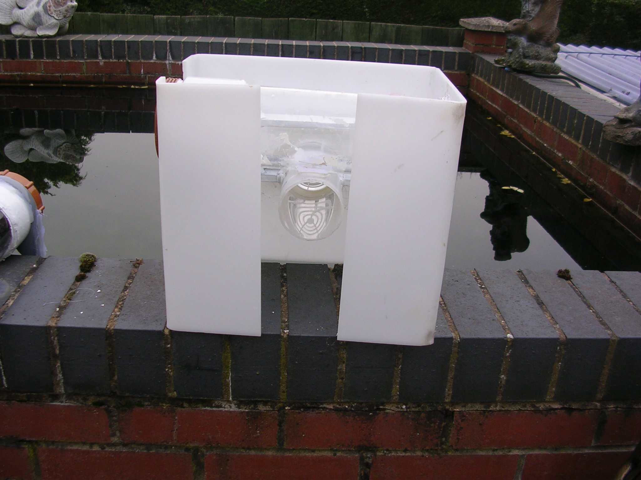

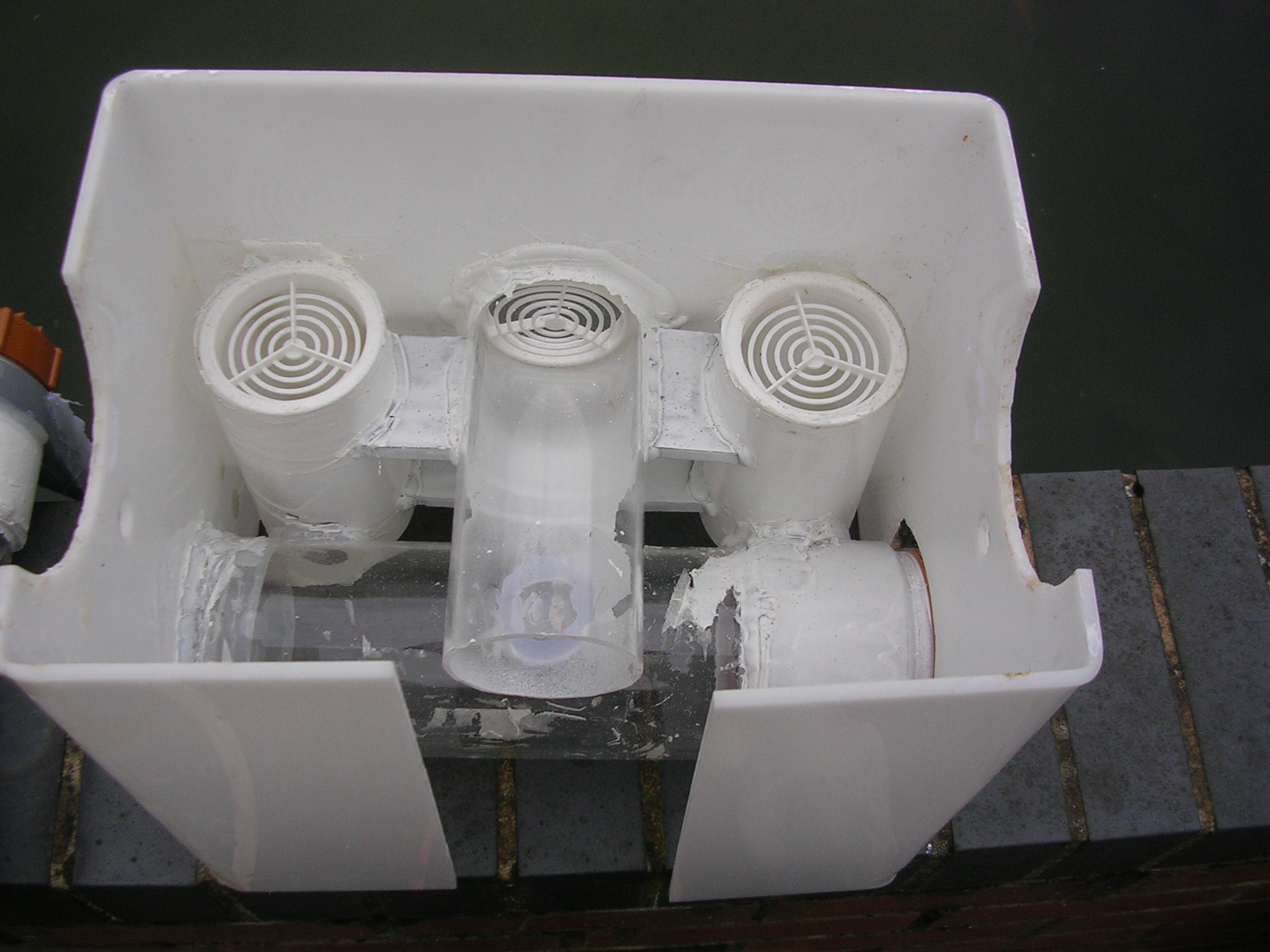

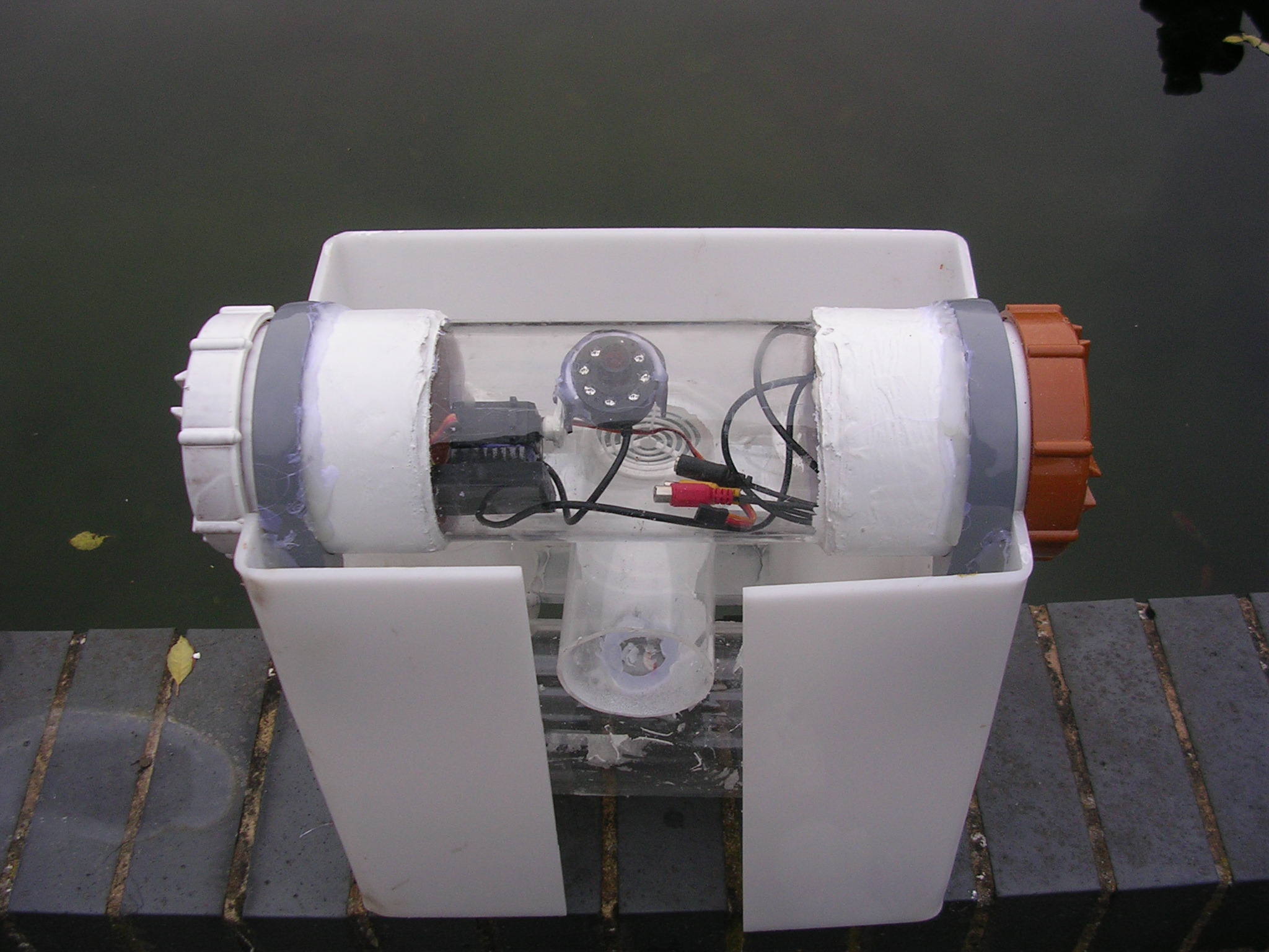

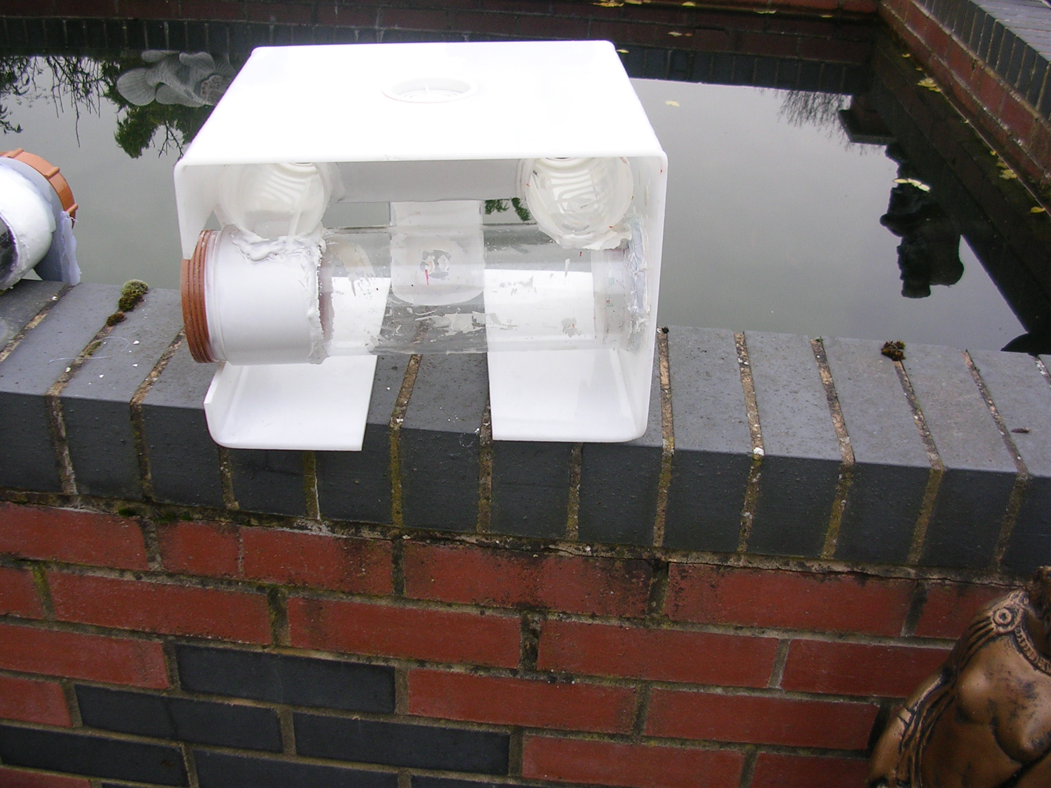

hi here are some pictures of progress so far need a lot of work yet but at least its watertight had it in the pond for a week and no leaks fans for motors on there way from China so stuck a bit till they arrive
Al

I like your main body. What is it constructed with?
BigAl999
Posts: 17
Joined: Jul 3rd, 2012, 9:23 am
Re: RC transmission through tether
Post by BigAl999 »
The body is 5 mm cast acrylic sheet that I bent myself with a small gas torch
The 2 sealed tubes are 100mm acrylic tubes with drain inspection ends.
The 3 thruster tubes are 75mm acrylic tube
Hope to get some more work done on it soon
