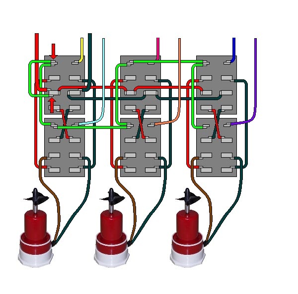

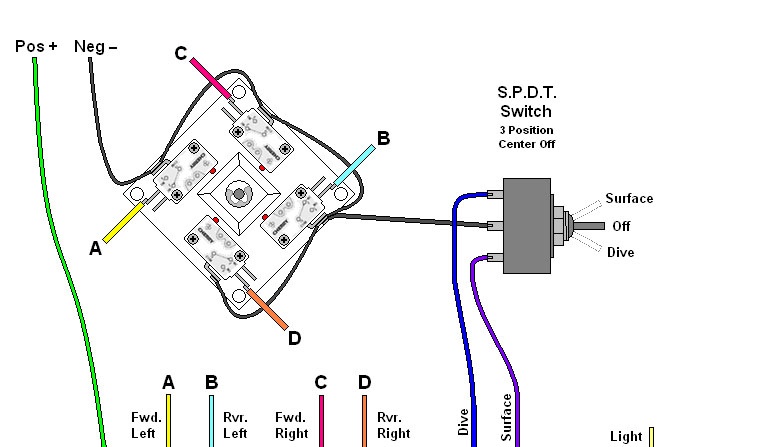

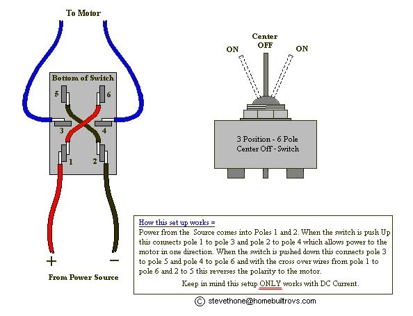

I'm completely new to soldering and to building ROVs. I would like to know if I should go with a simple setup using momentary flip switches as shown here in Figure 1. Or if I should use relays and Joysticks shown here in Figures 2 and 3. I personally want to use the joystick method because its easier to operate and would work better in my control box.
Figure 3 Joystick
Figure 3 Joystick
Figure 2 Relay
Figure 2 Relay
Figure 1 Switch
Figure 1 Switch

I would recommend to use the joystick. It's pretty easy to solder and much easier to manouver.
