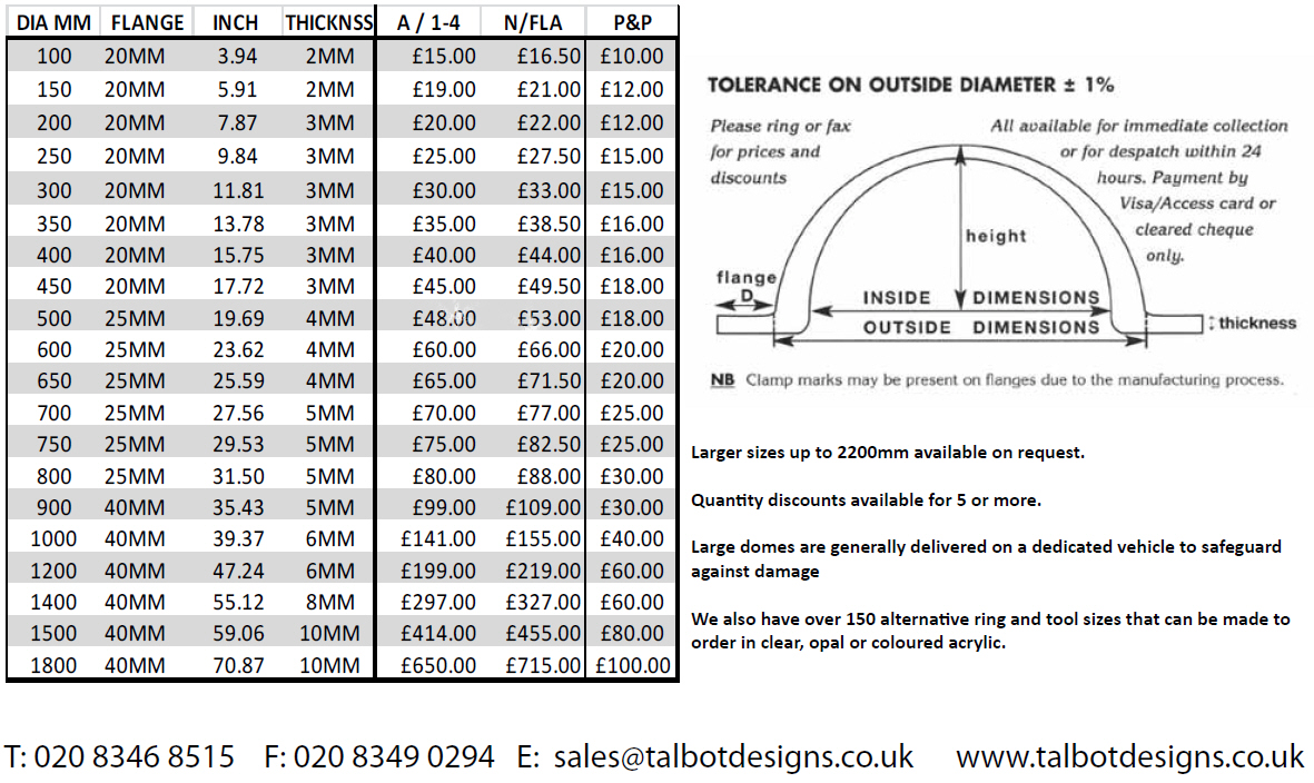

Hello All,
Was hoping you could comment on the following.
I found a UK supplier for acrylic domes. The price seems really good! HOWEVER, i am not sure the domes will be durable enough to meet my demands. I would like a dome that can withstand 7Bar (~100psi).
The listing for the 100mm dome has a 20mm flange, but the acrylic is only 2mm thick, (possible thinner near the center of the dome.)
I already wrote the the company, and they stated that they do not pressure test their product.
Any comment on weather or not this will be thick enough?
Thanks,
Ryan "KR2_Diving"

A 4" dome .080" thick at 100 psi...... I dont think I would trust it to hold much more than 50 psi. I had a 1" thick piece of polycarbonate 10" in diamater crack at 160 psi, but then it was a flat sheet and not a dome....... at the same time ive put 100 psi into a plastic pepsi bottle and it held...for a while any way..... :lol:
