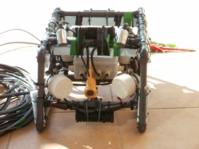

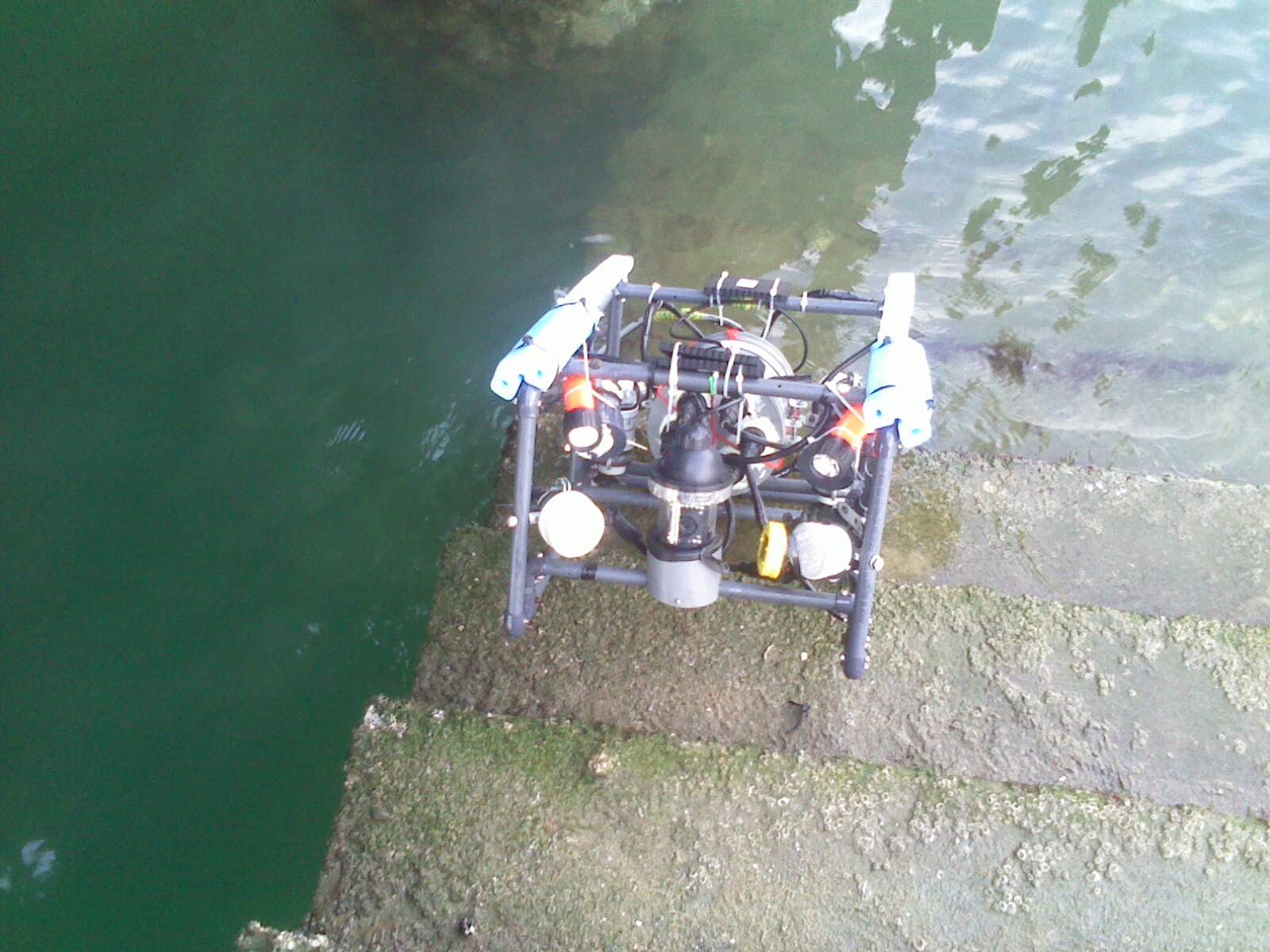

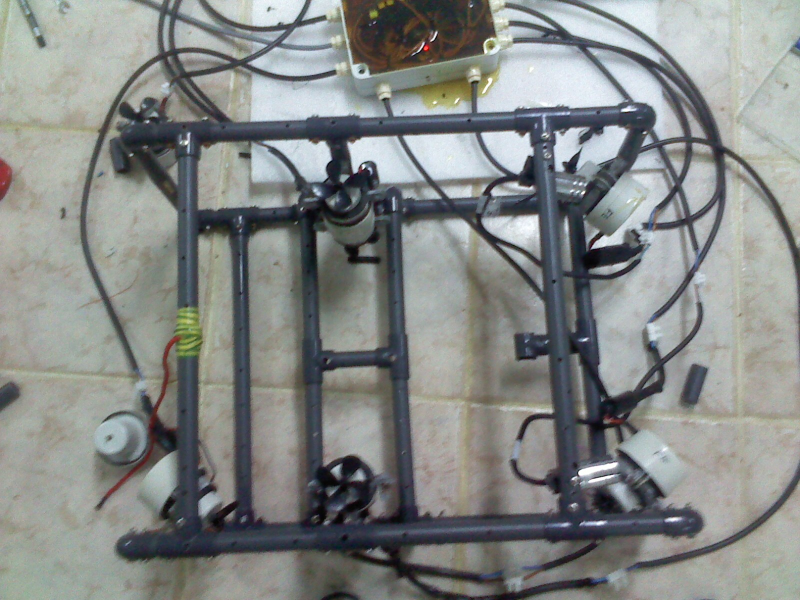

This is the ROV that I built.
Was tested at 6 meters and performed well.

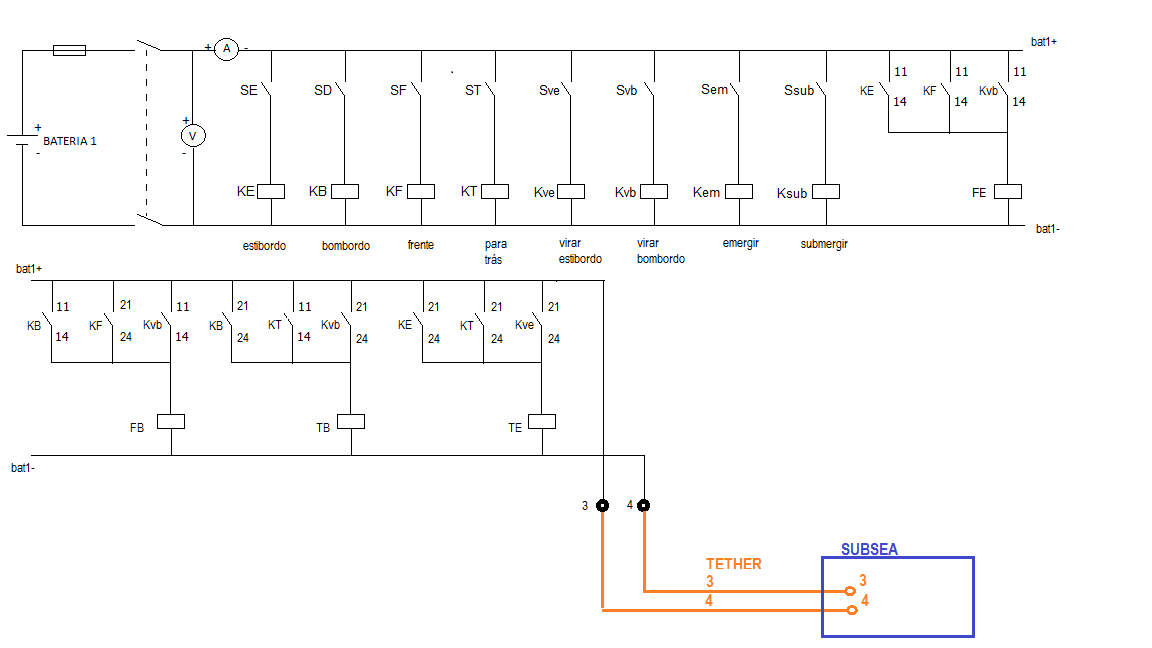

The control uses an Velleman kit to transmit the signals over two wires.
The surface control unit and subsea box uses relays to control the six thrusters.
Thrusters are 700GPH bilge pumps.
I will post the circuit diagram.
Frame: PVC pipe 20mm
Thrusters: 8 modified bilge pumps
Camera: Colour
Lights: 2 LED lights on the front
No depthmeter
No compass
18 meters of tether
Older version of the ROV on the launch point
ROV under construction

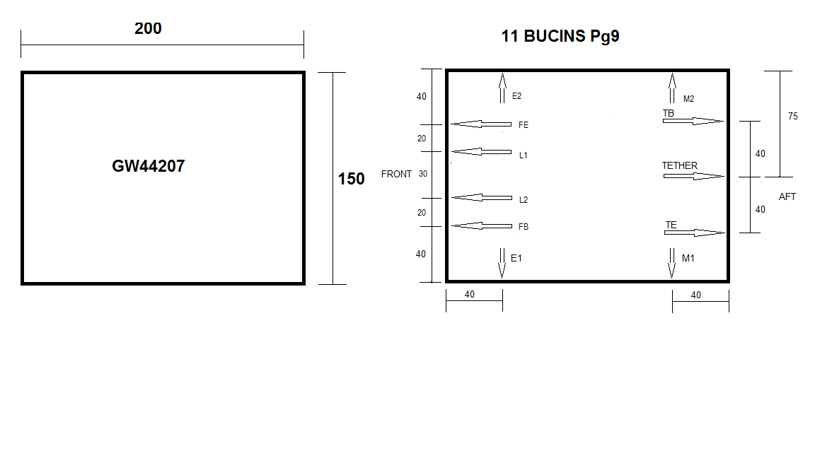

Layout of the 8 thrusters
Last version of the ROV

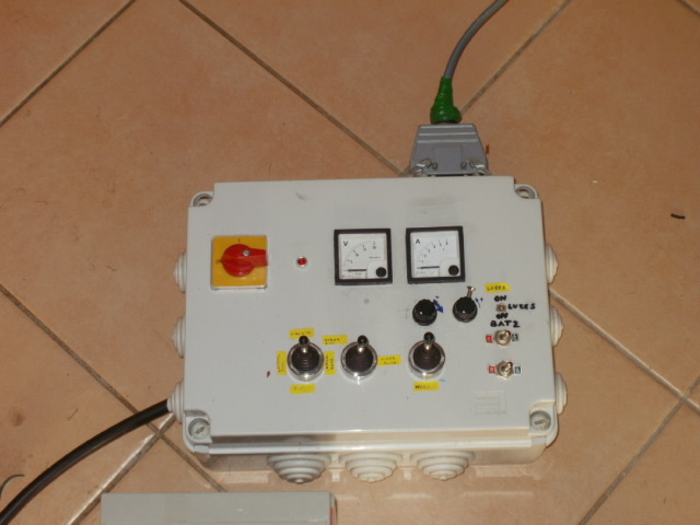

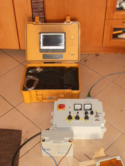

These are pictures from the contol Box and video system that I use in my ROV.
Video system and control Box
Video system
Video system
Control Box
Control Box

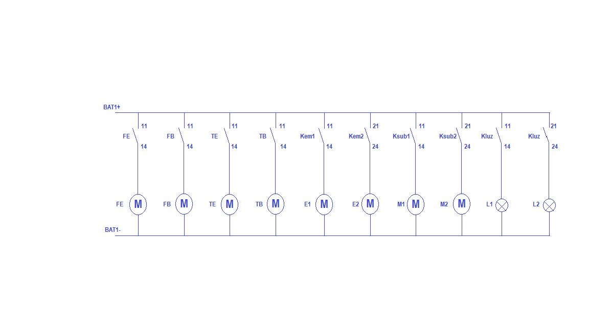

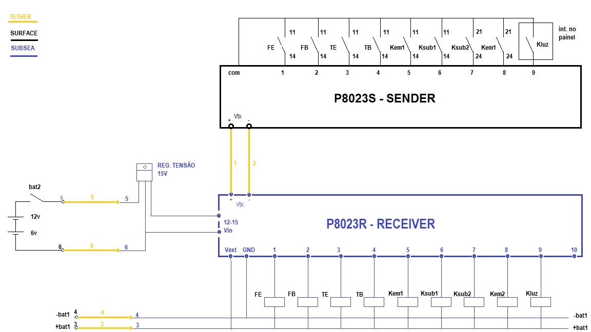

This is the schematics of the electronics on my ROV and control unit.
Layout EPOD.png (26.88 KiB) Viewed 7503 times
Esquema electrico3.png (22.22 KiB) Viewed 7503 times
Esquema electrico2.png (37.93 KiB) Viewed 7503 times
Esquema electrico.png (30.71 KiB) Viewed 7503 times
