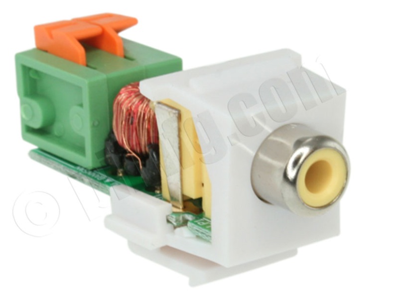

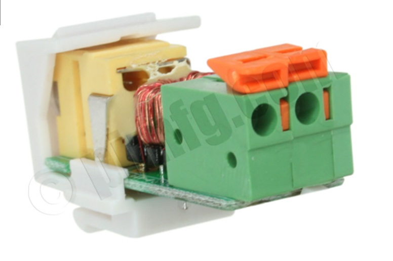

These are the ones I bought for RCA Video and Audio. No adapters required.
http://www.pimfg.com/Product-Detail/NVA-700-WH-YL
- RCAback.jpg (52.51 KiB) Viewed 6807 times
- RCAfront.jpg (57.28 KiB) Viewed 6807 times

Re: Camera Video over CAT5
That's perfect, I ordered a set!
Mine just arrived. Havent tested them yet. According to the information I dug up on them they work to 330 Feet and for myself should be more than enough.
