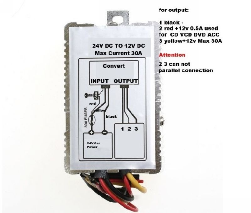

We have been doing some testing with running 24 volts down the tether and converting it to 12 volt DC at the ROV.
I just installed this unit on the ROV and have been running the ROV in a pool, and will perform some open water tests soon. The best part of the DC to DC converter is 5 amps down the tether will get you 10 amps at the ROV motors, so the line loss in your tether is reduced by the lower current draw. The 12 volt DC voltage drop down stream of the DC to DC convertor is very small as the wires between the converter and the motors is typically less then a couple of feet.
See this post for additional information viewtopic.php?f=15&t=774
The other thing I wanted to mention is stranded wire comes in two types.... thicker strands and fine strands. The thicker standed 14 gauge wire is typically used in AC conduit applications. The finer stranded wire is used in the automotive industry. The fine strand is more flexible.
If you have one, stop by your local surplus store, as they tend to have wire on bulk rolls at a great price. I typically pay .05 for 16 gauge and .06 for 14 gauge wire.
- 24 volt to 12 volt DC converter.
- 24v to 12v.jpg (106.78 KiB) Viewed 12941 times
Re: 12V speaker wire
OK
where did you find this???
I bought mine off of E-Bay
Enter this text in the eBay search field............ "24V to 12V DC to DC Car Power Supply 30a"
Or enter the same search info in Google, and click on images
Here is a typical listing in eBay
Buy it now $9.99 - free shipping
http://www.ebay.com/itm/DC-DC-Converter ... 2021wt_952
Jim
Jim
silent1mezzo
- Posts: 2
- Joined: Jul 23rd, 2012, 3:34 pm
What's the heat like on this thing? Would it melt through if I sealed it with wax?Rover wrote:I bought mine off of E-Bay
Jim
I am not sure the actual temp, but from our tests it wasn't that warm unless you were really pulling a lot of power from it. At that point, I would say it was warm enough to melt/soften wax.
Can you enclose it in a short 3" PVC tube with a threaded end cap, and pot the wires? That is what we do. It is a lot easier with out the wax. Or even a water pfoof pelican case.
