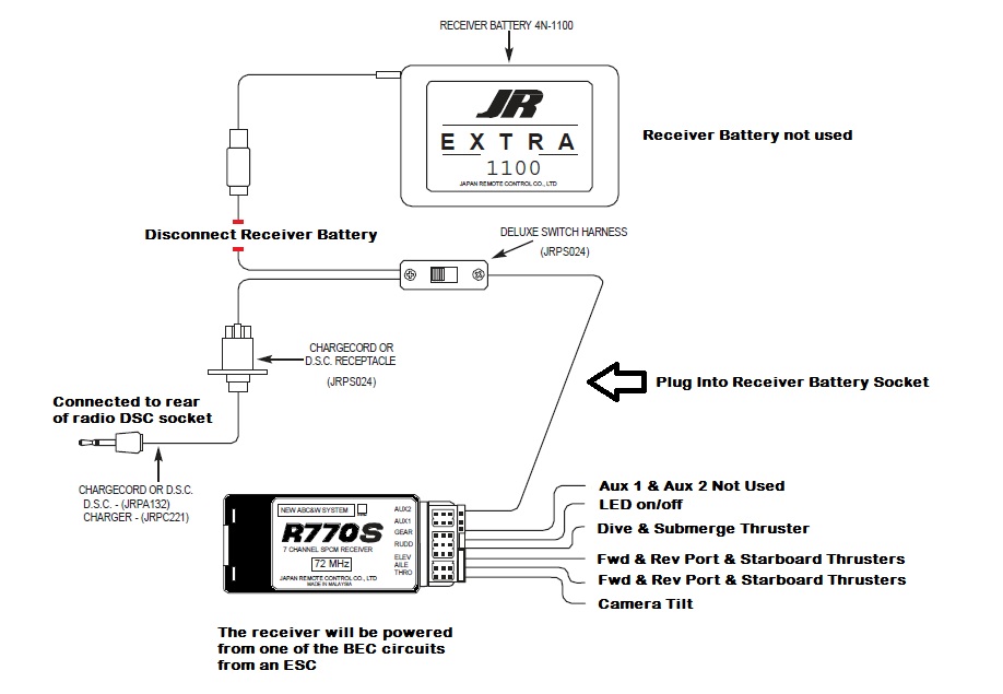

bikerbones1968
Posts: 374
Re: Threaded PVC end caps- waterproof?
Post by bikerbones1968 »
Thats why I asked about DSC function. DSC (direct servo control) equiped radios have a 1/8 jack on the back sometimes called a trainer port. Using the DSC port shuts down the transmitter. The transmitter then sends the signal to the receiver via a pair of wires rather than transmitting over the air. Radio waves dont travel through water very far. I am not sure how successfull anyone has been trying to extend the antenna on a conductor. I have read a few posts on here that they made it work but as far as how well I am not sure. It goes against my understanding of how radio antennas operate so I avoided that experiment all together and looked for a DSC radio.

ok i have it backwards then i thought the transmitted signal ran down the wire but yes it has a trainer plug so u just tap into the trainer port ppm i think do u tie it into the rec?
bikerbones1968
Posts: 374
With my radio (JR XP6102) the special DSC cord plugs into the back of the radio transmitter and the other end plugs directly into the receiver battery terminal. Mine is set up like this:
