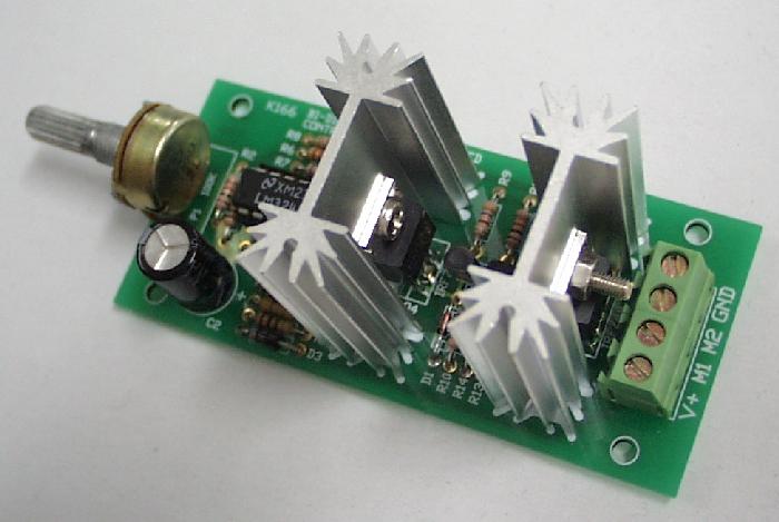

On a previous ROV our horziontal thrusters were controlled by relays, but I wanted a way to control my vertical position, so I add a bi-directional speed control I bought from Carls's Electronics...... http://www.electronickits.com/kit/compl ... r/k166.htm
This little kit uses a pot to control speed. I remotely connected the three wires for the pot in my drivers box on the surface. This gave me precise up and down thruster speed.
If you have a PWM signal at the ROV, then a brushed ESC (electronic speed control) is the way to go.
