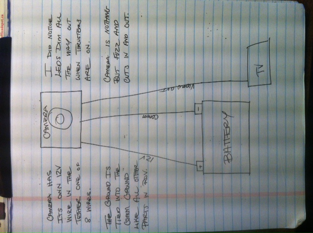

if you can post some photos and a diagram of your wireing i think i may be able to help you a little more.

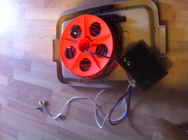

Ok guys here it is.
timothyalderson
Posts: 92
Re: Trying something Different....
Post by timothyalderson »
Crap I messed that up. The camera has a separate power wire. Everything else is the same.

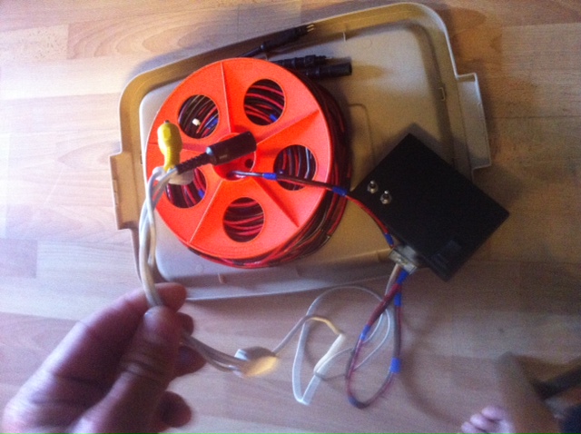

your video out wire has 2 wires in it and it needs to be grounded as well. if you cut the cable there will be a single coted wire in the middle surrounded by a bare wire. that bare wire is a grounding wire and needs to run from the camera to the video monitor. i belive that is the problem, take a look at your layout and make sure its grounded properly try running the camera directly and see if that fixes the problem.

My camera doesn't have a shielded wire. Ill take a picture of the camera.
