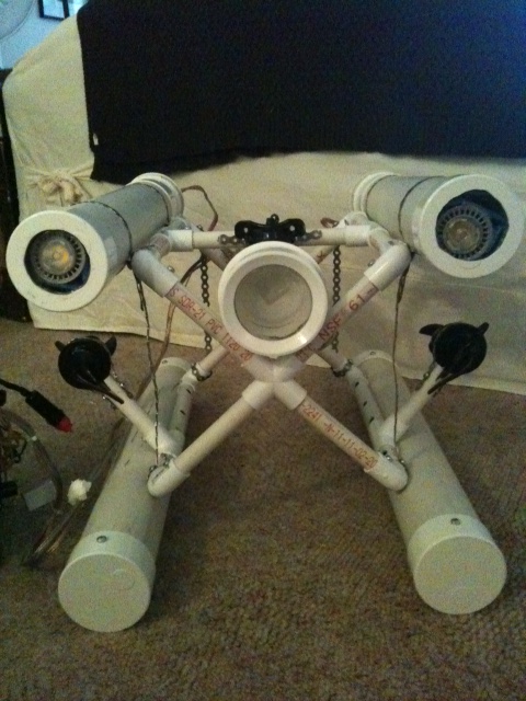

the actual ROV (ROZ as I call it) is made up of 1/2 inch pvc for the x-frame and 3 inch for the ballast and float tubes. the design is a bit different than what I had originally wanted but when i priced out what it was going to cost me for metal I decided this was easier.
I cant think of what else to add right now so... PICTURES!
the frame
with thruster mounts
with thruster mounts and ballast tubes
for size
http://s954.photobucket.com/albums/ae25 ... windex.jpg
with thruster mounts ballast tubes floats and camera housing
constructive comments are always welcomed :)

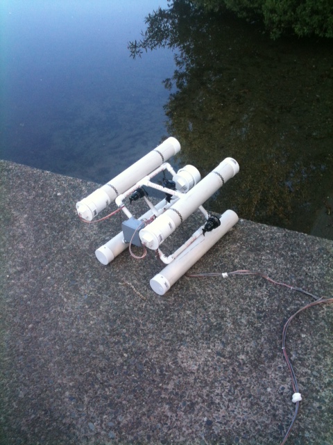

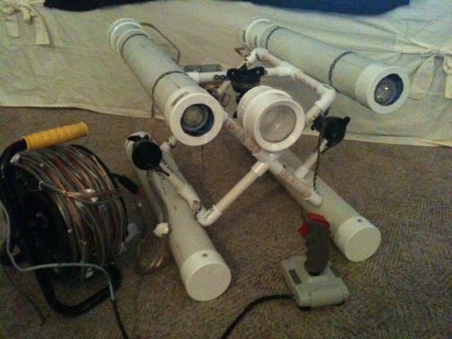

still waiting on the camera, but its ready for testing! here are some pics of the completed ROZ, and I will try and take some of the testing and maybe even a video.

are all four of those bigger pvc tubes sealed? If so, I think you may have way too much positive bouyancy. also, I'd suggest removing the bottom two tubes all together. you want to put the sealed buyancy tanks on the top and the counter ballast on the bottom so that the rov floats level in the water and will right itself automatically.

the bottom tubes are filled with holes and weight as my ballast, the top tubes are sealed. the reason that i have the bottom tubes as ballast is because i like the ascetics.

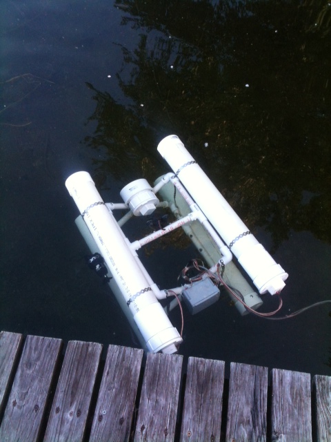

First test run!!! went really well! except i only had 2 of the new propellers and the old one fell off as I figured it would, so I only had 20 min with the dive/surface thruster working.
also learned some things.
- my ballast takes take a long time to fill with water so I will have to drill larger holes for the water to enter.
-I need more floats on my teather, dragging it through the sand/dirt below the ROV sucks up speed.
-I made the controls backwards (left forward made the left thruster go forward, turning it to the right)
-zip ties are not a good way to hold teather wires together as they get caught and cut your fingers.
