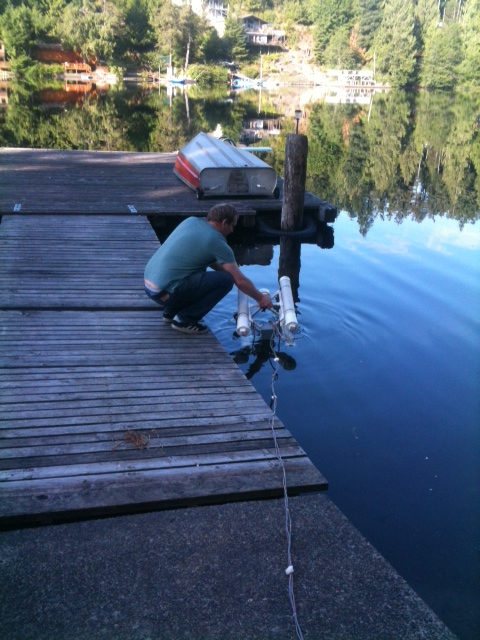

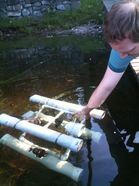

First test run!!! went really well! except i only had 2 of the new propellers and the old one fell off as I figured it would, so I only had 20 min with the dive/surface thruster working.
also learned some things.
- my ballast takes take a long time to fill with water so I will have to drill larger holes for the water to enter.
-I need more floats on my teather, dragging it through the sand/dirt below the ROV sucks up speed.
-I made the controls backwards (left forward made the left thruster go forward, turning it to the right)
-zip ties are not a good way to hold teather wires together as they get caught and cut your fingers.
anyways some pics
