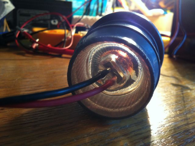

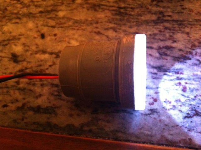

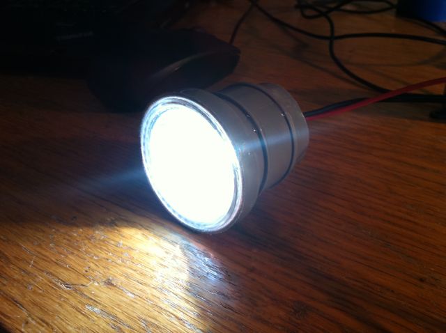

I used 2 component epoxy resin for potting my LED lights.
- IMG_0609.jpg (54.71 KiB) Viewed 15109 times
- IMG_0601.jpg (41.9 KiB) Viewed 15109 times
- IMG_0597.jpg (57.17 KiB) Viewed 15109 times
