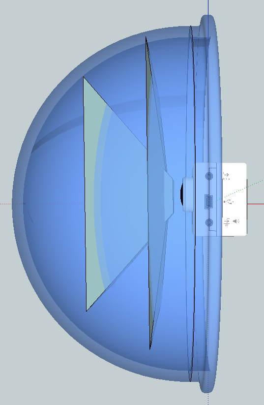

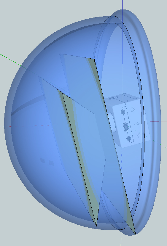

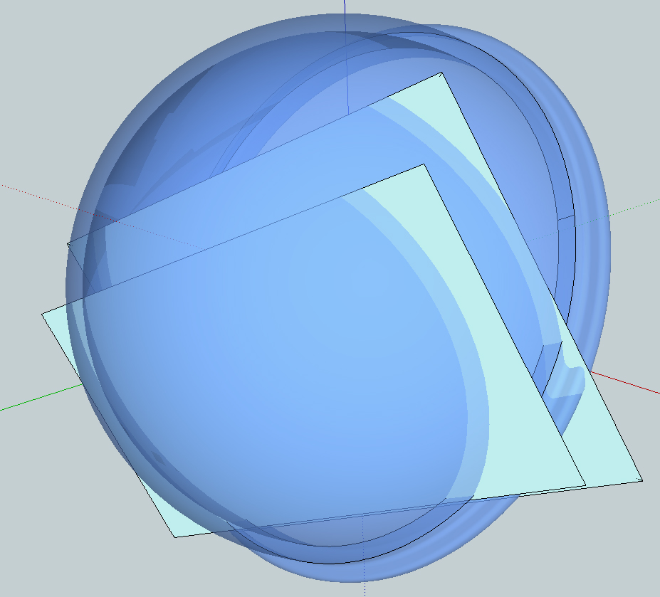

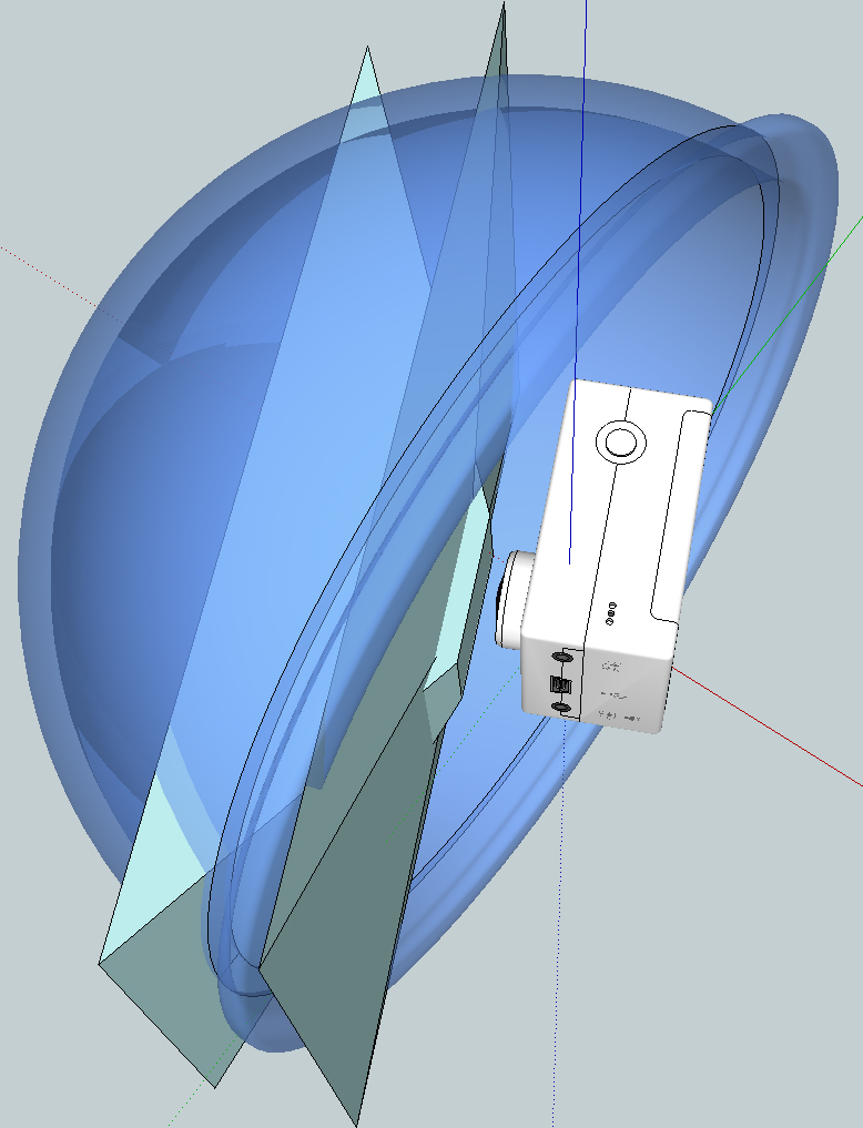

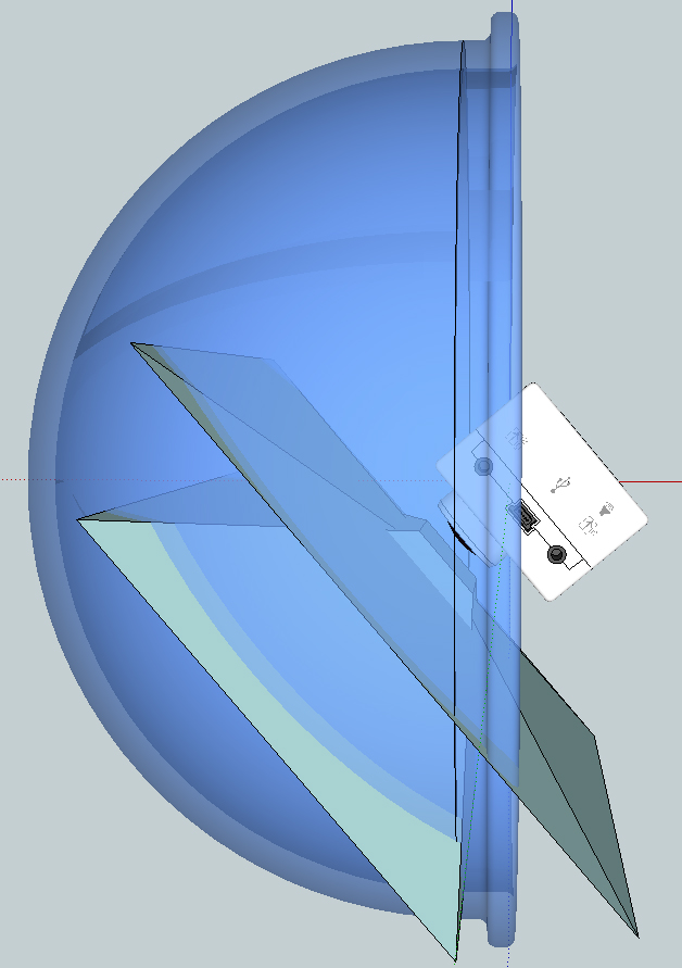

Hi All,
I agree that dome is very large, too large. It reduced to 200mm when, on the advice of forum members, I took out the roll function, but as Derelicte pointed out that’s not much of a saving.
On reflection I would have been better of starting from working out the amount of camera movement require to provide an all-round view. I was surprised that I only need 45 degrees of travel in the vertical and up to 30 in the horizontal. Much less that I had imagined.
The images below show the field of vision from the camera at an angle of 90 and at wide angle 170 degrees, 1080 HD. The dome in the pictures has an outside dimension of 200mm. I don’t want to go any smaller because the pressure chamber to which it is to be fitted has to contain a lot of equipment.
Mareike – The servo exoskeleton was purchased from ServoCity.
GadgetGuy asked how deep I plan to dive the vehicle – 100 meters but perhaps up to 150.
What thickness of acrylic plastic would the forum recommend for a 200mm dome at 100/150 meters?
