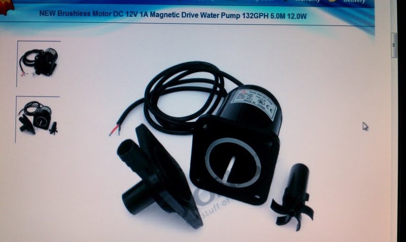

hermetically closed motor housing, have you seen this?? maybe we could find a larger version? http://www.ebay.com.au/itm/NEW-Brushles ... 0790275166
- thruster.jpg (35.46 KiB) Viewed 38285 times
